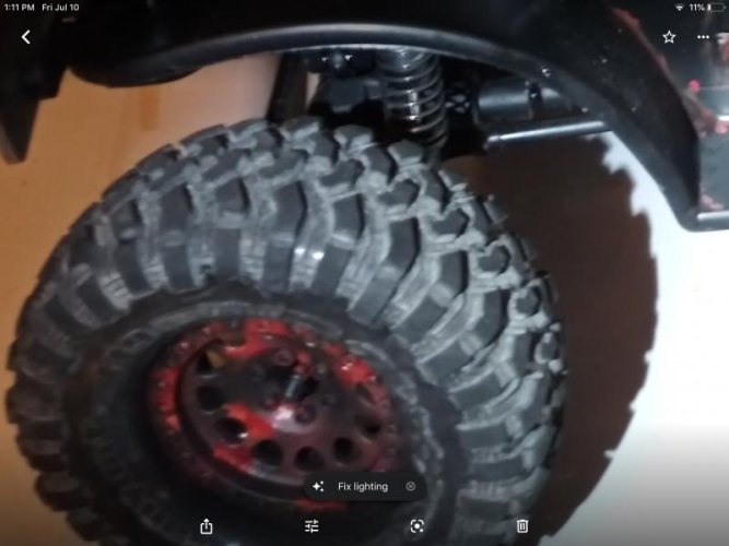

Have you thought about the tire mod ? Either small dykes or a sharp razor knife.
Yeah i have thought about it quite a lot but i haven't felt like i needed it yet. The way they are they seem to handle rocks and logs really well. I haven't done much dirt driving so maybe when i try that more i might do the mod..
I have 2 nearly identical rigs. I strictly slow crawl on rocks only. I was very impressed, they pull as well as the rock beasts in a comparison crawl.
