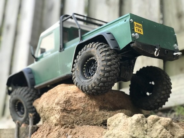

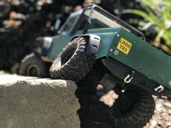

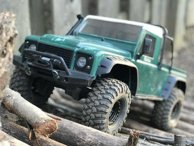

Did a little flowerbed crawlin and built a see saw for our backyard course.
Over a couple days i installed a new steering servo, Castle BEC to provide 7.4V to steering servo, DIY BEC bypass wire, underdrive diff gears in rear, and a new(ish) crawler course (i had a large tree taken down on my property and they left the wood). Loving the Blazer except for the poor approach and even worse departure angles. have a few items on the way to fix that.

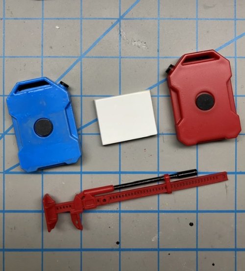

Today we made a couple adjustments to the body to fix some rubbing issues. Did a little detailing on my recovery gear too"thumbsup"
