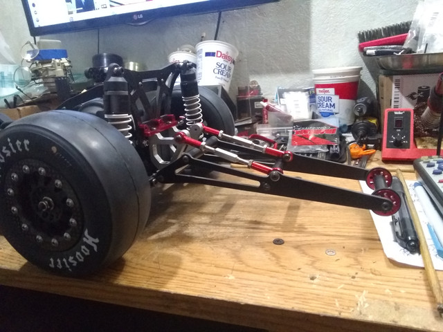

Took a few minutes, about 60 of them lol, and got the DRC Wheely Bar Wheels on. Used a couple pieces of body post as bushings, trimmed them for length, put a hole through the center, then trimmed down the wheely bar spacer/brace so it all fit on the inside as it should. Just need to add the longer rod ends back on the adjusters so I can drop the wheely bar about 1/2 in more.

Also swapped out the crappy Traxxas Servo Saver for a normal Aluminum arm.

Put the Fast Eddy Ceramic Bearings into the carriers and got them installed today. They fit in very well. Snug but not too snug, though it did take a couple of taps to get them fully seated. Nice pieces and their cost is excellent.

Got some Gorilla Tape and made up some anit-pizzacutter bands, put them on and got the Corrupted Carbon 12 hole cf beadlock rings installed.
Adj Wheely Bar Links in Red installed.
