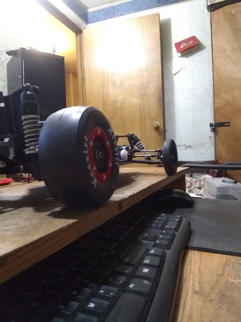

Here she is in pretty much Slider condition. Everything is new.

Put the wheels on and the rear did have some toe out happening, so I swapped the rear arms (had them opposite to start). Moved the shocks from the stock mount positions inward to where the tower now mounts to the rear upper part of the chassis, laying them down a bit more then drilled them for shock mount locations.
Now the rear Toe is gone and zeroed out and the shocks don't rub the rear wheels.
I went ahead and added the wheelie bar, that came with the Kit. Need to get wheels for it and get them installed.
Also got bearings in the front wheels and got them on, need to get a thin inner spacer with these wheels to make them work better on these TRX Stub shafts, so I may just move to a Tmore normal front wheel.
put the bandit front wheels on. These may be a bit small, but I plan on getting a bigger O-rings for them, which will bring them up a bit.
