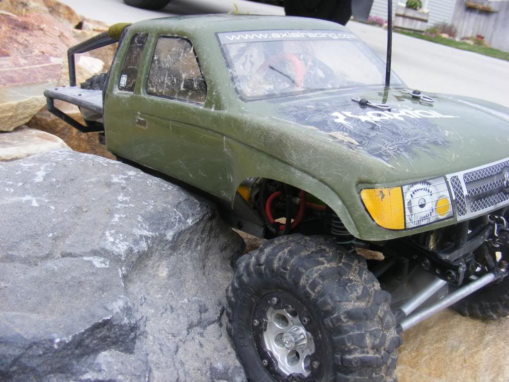

So I decided to go ahead and make my own tie rod and drag link to match my suspension and get rid of some of the slop. I took the advice I remembered from you and took the horn off and for the life of me could not get it centered, so I was going to live with what I had until I see you said adjust the drag link length...now it makes sense...I can do that tomorrow. Anyways here is what she looks like now. "thumbsup"

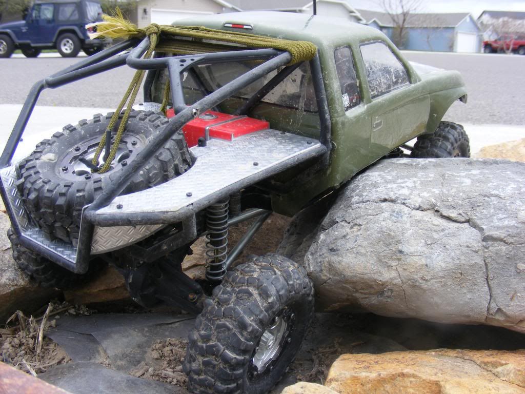

Also a few changes have been made. I bought a new servo arm after I hit a rock and stripped the stock plastic one. I then went and mirrored the transmission and while I was in there I went ahead and made it a little water resistant. The mirroring has worked out good and I am pleased with it. I also cut the sides off of the front bumper and that has made a big difference in getting up onto rocks without having to come at an angle. Anyways, on to pics...
The new servo arm
The mirroring of the transmission
Before the bumper
And after

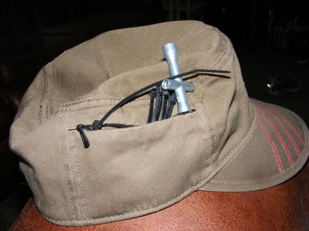

I also should share my new attire. I took my family to a Monster Jam event in Boise a few weeks ago and they had this grab bag of stuff for ten bucks. I buy it and it comes with this semi-crappy hat that my wife does not like me wearing because she does not like the looks of it. :shock: In the pictures I want you to notice the little zippers it has on it. Well, that gave me the genius idea to put all the little tools and crap I need in to those two zippered pockets to have with me on the trail. Allen wrenches, zip ties, and the 4 way tool all have a place and I dont feel them in the hat. Plus...it says RC on the side so it must have been destiny or something . . . :roll:

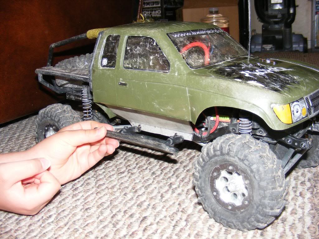

Went to every hardware store and metal dealer I could find today and nobody had stainless steel tubing for a four link suspension, so I just opted for some brake line instead. I used 8-32 all thread all the way through with the Revo ball ends #5347. The LHS only had one packet so next week I will get the fronts done. Do you guys run shorter front links or has anyone ran same length back and front? Much of a difference? Also here is a link for an easy way to put in the ball ends for the Revo's that I found, hope it might help somebody at least. Also used some sandpaper to make the brake line look a little bit better.

And on to pictures of the links...
Nice rig man. Liking the links as well. I run the links at their stock lengths with the exception of the upper rears. I run those a tad longer by using the longer rod ends to tilt the rear pinion up a tad to keep the driveshaft from binding at full travel.
Oh and welcome to the disease! I have it as well!
I ran all of my rear links the exact same length and it gives me a real nice driveline angle. I have read that it is better clearance on the pumpkin also, but I have not noticed a difference.
