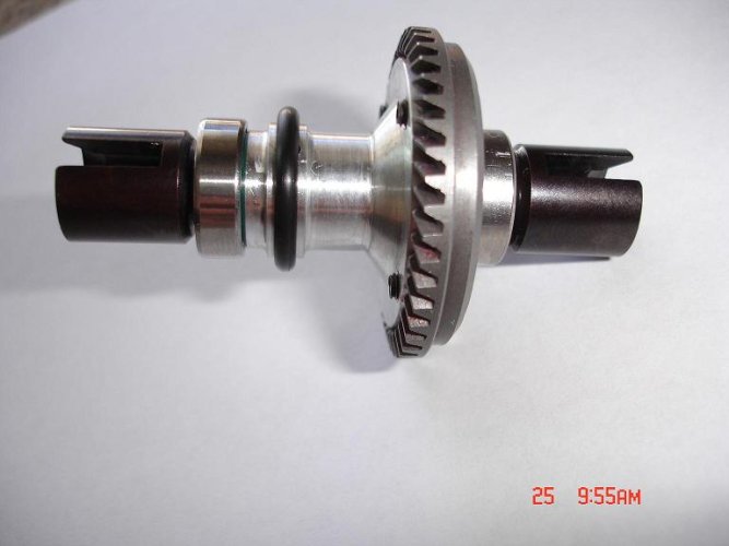

lst aft losi ring gear versus Kyosho ofna
How thick are those Ring gears ?
I just received the Lightening helicut gears and the ring gear is a massive 8mm thick
Anyone come across a 5.7mm thick Ring gear ?
OK which Kyosho set (pt# would be helpfull) dose not work. The IS007 has been used the most around hear. The MA050 set is a direct helical set for the Mad Force, same housing as the Twin. The HB set C9009, C9010 also have been used. They can not be drilled to except the Revo shafts, but the CEN shafts will work with the set screw to secure them. MAKKEM is also using these HB gears with modified revo shafts.
