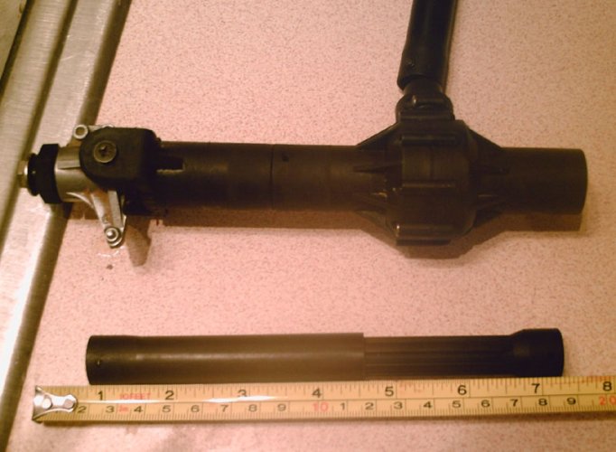

The inner shaft has 6 thick splines.
Collapsed Length (pin to pin) = 4-1/8"
Extended Length (pin to pin with 1-1/8" sleeved in the shaft) = 6-1/8"

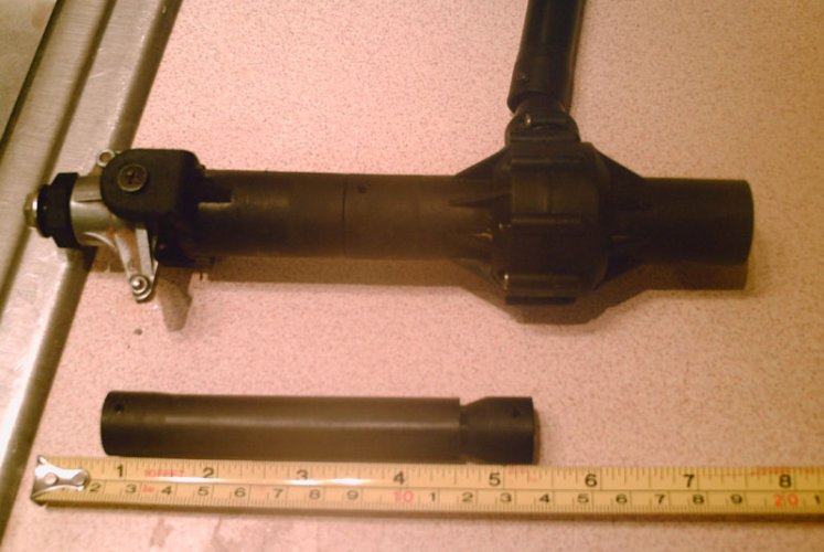

Each half is right around 4" long (overall).

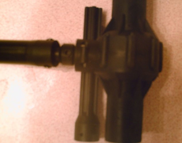

Just showing how the ball joint joins the driveshaft and pinion shaft.

Oops, sorry guys, I missed the last few posts. You can double up on the female ends of the drive shafts to lengthen them just like pede shafts. The shafts are plastic but the pieces that go on the pinions are hardened steel.
