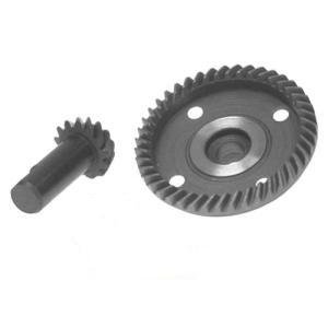

I was browsing on Kyosho's website and found that the newer
ST-RR truggy has chromoly R&Ps. I wasn't able to find a part number(maybe RCP could get it) or any useful information.
I'll keep looking.
I found the 777 ST-RR uses 10t pinion IF102 and 43t ring IS101. I though I read this ST-RR was an Inferno but they don't list the Inferno on the parts breakdowns.
Well under a little more investigation this is the ST-RR. They list the light weight swing shafts that it has. Hope this helps.
I'll keep looking.
Did anybody figure out if these work? I found the parts # for the R&P's they are 10/42 ratio.I was reading and it sounds like they are a direct replacement for the ST-R R&P.
This is what it says.
"These are the new harder versions of the ST-R bevel gears."
