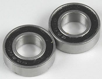

Rubber sealed 8x16mm bearings(4) #LXJBE2/C8020-1

Rubber sealed 8x16mm bearings (2) #LXBZP0/36053

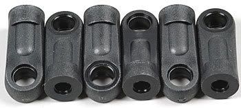

Here are some VERY beefy ball ends for links
6-7mm balls #LXCWJ4/36850
6-7mm ball end #LXCWH9/36690
