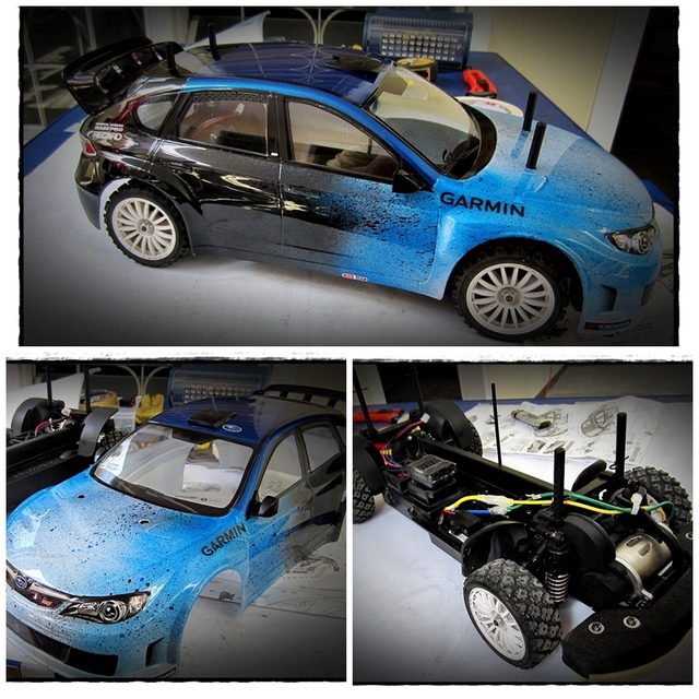

Well Rodney and I started talking about painting bodies today, that along with the CRC series starting next saturday and I decided I needed to paint up a new shell for the beginning of the series.
I had a couple Tamiya Subaru bodies sitting around, so I picked out a 2001 Subaru Impreza and did the fastest paint job I have every done. :ror:
It turned out pretty good and I went photo crazy. :mrgreen:
-Ty

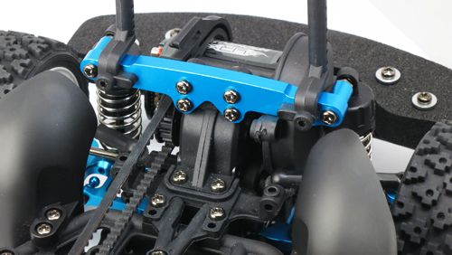

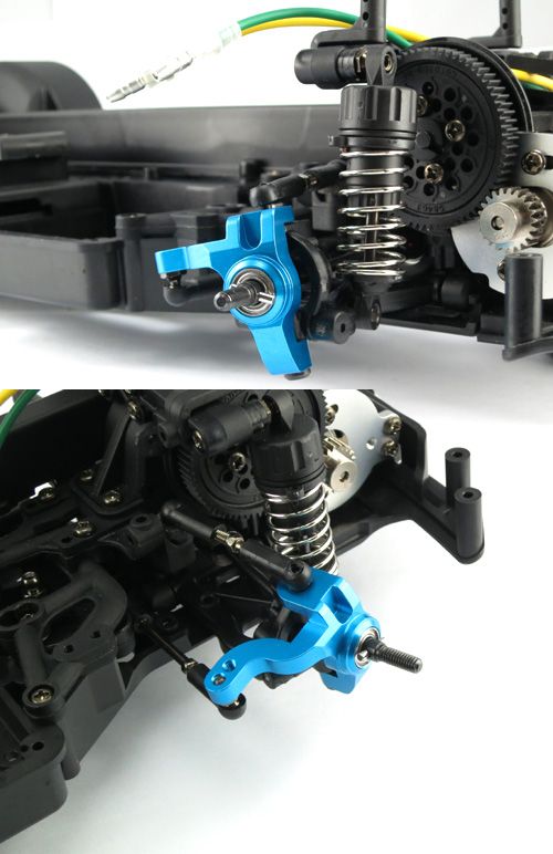

I just did some digging and found a bunch of metal parts, not sure if you guys have seen these but here they are. I am still on the look out for some metal steering parts if anyone finds some.
A yeah Racing kit;
A arms, shock towers and knuckles

If you are referring to toe blocks:
There have been several people that have broken the stock plastic toe blocks (generally the equivalent to Tamiya 1XJ). So because of seeing and hearing about these breaking I decided to replace them before there was an issue. I am sure there are other reasons to replace them, but I did it for durability.
If you are referring to shock towers and A arms:
They will make the shock towers more rigid, which creates more precise handling. Personally though, unless I start breaking them have no plans to buy the metal A arms or shock towers, seems like over kill to me and I don't think it will add all that much in handling.

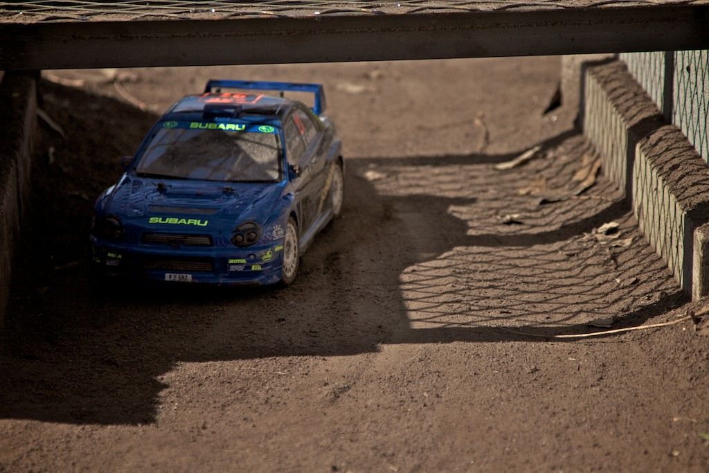

Event went great yesterday. I grabbed some photos from Skidplate and RPMJ of the XV-01.
Very cool, love seeing people really getting into rally.
