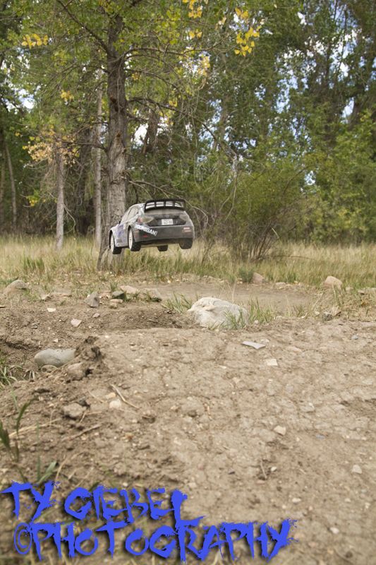

Got some photos from HOON 470 today.
And a little jump sequence.

And some Hooning. "thumbsup"
Such a fantastic car!

Looks like you were putting it to task my man, great shots!

Oh yeah it got jumped probably 50 times and there was not a single issue. I was running the cover on the electronics and it did get a little hot (as far as I could tell through the plastic). I have been thinking of mounting a fan directly to the cover on the outside similar to how I mounted it on my Exo Terra, that system should help with the cooling. I haven't decided if I am going to mount it straight on the box or a build a little "tower" so it is harder for water and mud to get it...

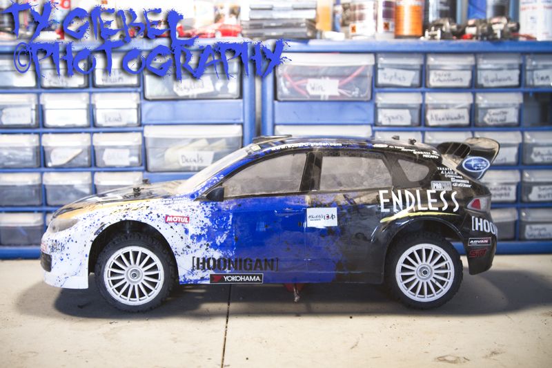

I also worked on painting the body today, I almost went with the stock paint then decided I needed a new paint scheme for the >2013 CRC series< and this body was the perfect one to play with some ideas.

You better just buy one Jake. Its a fantastic car. :mrgreen:
