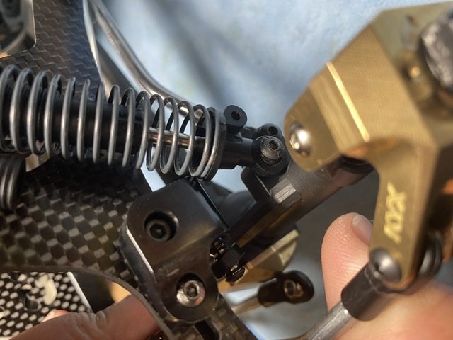

If you have a minute, can you give me an eye to eye length of your front links? I think mine are too long. I'm using the V3 chassis, AR44's and the aluminum pan hard mount. My track bar is hitting the upper link mount of the axle and my shock doesn't clear the pan hard mount to get full compression. Thanks!

These are from last night. I have since moved the PH mount forward one hole and it lines up better but I can only use one screw to attach to the chassis. I was looking at your pics this morning ans saw that the front axle sits way further back than mine. I'll measure my WB and get some better pics after work. Thanks for your time bro.

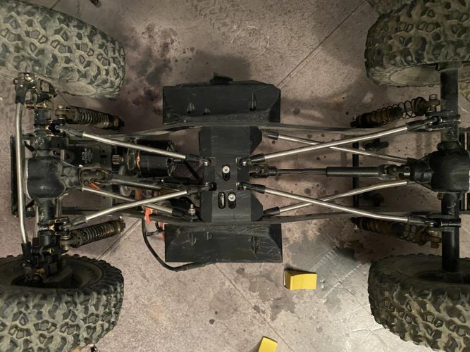

Are your links set up like this?
Longest to shortest
Rear lower
Rear upper
Front lower
Front upper
I’ve had similar issues with his links before, and the replacement links I got didn’t help either but when I got a different set they worked perfect. My fronts were too long also.
Hope this pic helps. Rough measurement puts the front lower around 120mm. Maybe a tad more.

Should also point out that the panhard mount topher is running is the TGH panhard and the panhard you are running is the aluminum from the v3 carbon combo ( I also have this combo currently taped to the cardboard it was shipped in haha), which is exactly why I have yet to order links from either hardcore RC or intheworksRC because I have yet to hear if either/neither/both will work with the gspeed aluminum panhard mount and I dont want to buy a nice link set and have to jimmy rig the panhard.
Yes Duke is correct. I’m running the tgh mount. I don’t think it would solve his problem though because the tgh mount is in the same relative location on the chassis, it just allows for a longer panhard bar. Which translates to less axle swing. Lou’s problem looks to be too long of front links which wouldn’t allow him to connect the panhard properly. The multi platform panhard might work a little better?
On hardcore RC, the “wertymade” option is the on the that comes with the kit, and the same as the aluminum one gspeed just put out if that’s what you’re referring to.
That’s good to know. I also wasn’t sure if your tgh Mount was more low profile to allow for more shock clearance also, which he indicated as being an issue
I just measured all my links. I ordered the SS/ aluminum hybrid link set. The lower links are Stainless and those measure 135mm and 124mm. The three aluminum links all measure 120.5mm. I’m gonna try the 120’s up front and see how that shakes out... I’m not to confident that they will line up though...
