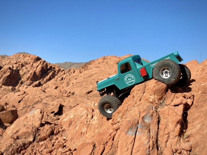

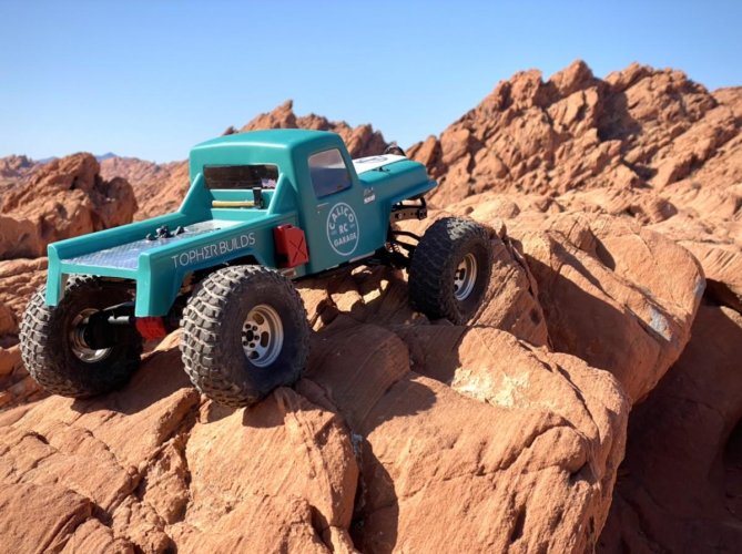

I spent some quality time with the sherpa this past weekend and had a lot of fun wheeling it. Visited Logandale trails out in valley of fire for the final day of scale nationals to check out some action and get some wheeling in.
The event looked like a blast, the class 3 courses were wicked and the king of Logandale race was a doozy. I wish I could have spent more of the weekend out there, but we’ll be back out there soon as the final round of the local comps is out there. Thinking about actually competing in that one but we’ll see how it plays out.
Anyway, here’s a video of a lot of Sherpa action and a few clips from when I met up with others at the event. It’s a beautiful space out there, can’t wait to get back.
