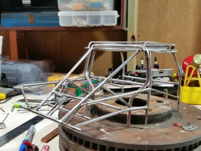

almost done with the tubes. my optional lightbar/roofrack contraption is pretty much finished.
gonna throw the rig together this afternoon and see how things are lookin.

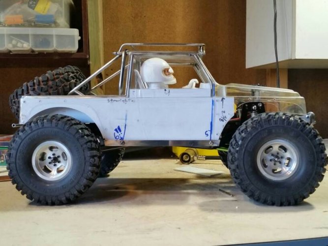

i still gotta do front inner fenders and some kind of headlight supports, gonna use the cobs or at least build it so i can swap them out with something less weird looking if i dont like it or want a more scale option. maybe get a stainless grill made.
kinda thinking about tubing out something up front and getting those loopy shock mounts going on so i can get some 100mm shocks with internal springs and end up with the same travel a 90mm shock would have. right now with the springs inside the proline scaler shocks on both sides of the piston i get 20mm travel, and i'd like juuuust a bit more.

i could get a stainless grill made and braze some little front clip support, but i kinda want to wrap this build up, and i can always revisit it later.

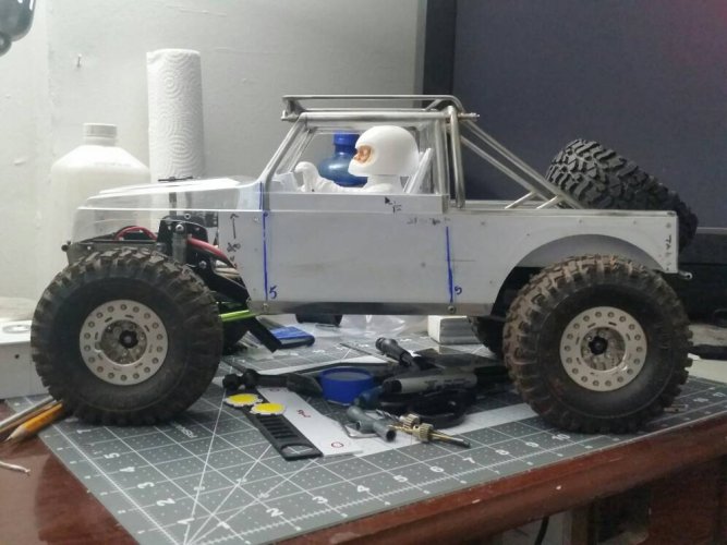

when i get back to it i think im going to scrap the toyzuki chassis and rework it for a regular set of steel axle rails so i can run it in c1 as i originally intended. "thumbsup"
or in that time source a set of alum zuki rails... i forget i have the sliders really tied into the rail design. anyway, ill update the thread when i get back to it.

if i was going to go that far i'd just make my own set of rails and rework the sliders to mount directly to them. with a stock set of rails i could still run the toyzuki drivetrain and my time spent on the interior and transmission/tcase tunnel would still be relevant. and then i'd just remove the toyzuki slider plates and braze the sliders&bumpers directly to the chassis.
