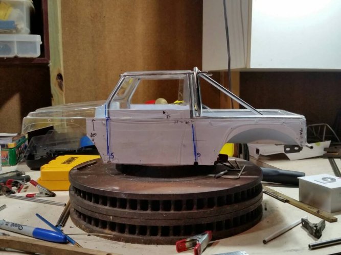

thinking a simple tube bed under the lexan bed rails, with a roll bar behind the cab and the angled bars of the roll bar going all the way back like this.
i also totally dig this... which is basically the fastback look but with a couple more hoops. kinda thinking of making a removable section so i can run fastback or full top like this. ...part of the reason i have those open tubes in the interior cage.

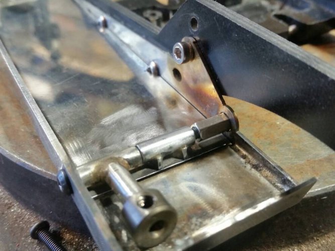

got the collars brazed on the cage mounts. i put the grub screws at a 90° angle to the rails, but really shoulda put them at a 45 so they were a bit easier to get too... nbd but i wish i had thought it out before brazing them up...
you see how the rear cage tubes arent exactly verticle? its to match the lines of the cab, but my original idea of just brazing the cage mounts to the sliders wont work since if all 4 of those mounts are solid, the cage dowels wont be able to slip inside... which means i'll probably not braze the front mounts to the rails. not a huge thing but a bit of a DOH moment.

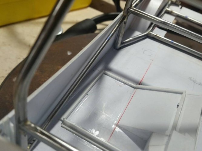

and i started on the tube bed, had it basically done but something got borked somewhere and i ended up having to cut it apart and rework a bunch to get it squared with the cage and body.
im on the fence on whether or not to braze the tube bed to the cage. i probably will but im gonna think about it. i originally wanted a somewhat light but scaled out comp rig, this is starting to take away from that. (ugly cross tubes are just there until i get the real tubes brazed in place.)
and to make things even more complicated and time consuming i bent up a 1/4" roll bar. i dont know if i'll braze it to the cage or just have it attach via the lightbar rods, or if i'll even use it at all. it absolutely makes the rig more complicated unless i just cut the top off the lexan body. also... just by the nature of my lightbar/roofrack design the roll bar will have visible m3 nuts on the back, which in a comp would work decent for running the winchline around and pull the rig sideways back on its wheels, but... theres gonna be visible nuts. i've scoped some different style nuts on mcmaster that might not look at bad as a typical m3 nut, so we'll see.
instead of trying to braze 4 pieces of fishmouthed 3/16 to the rollbar and keep everything straight, i took a center punch, a 1/8" drillbit, and my trusty dremel and very very carefully hogged out the rollbar so a piece of 3/16 tube could slide through. a bit tricky, and even more tricky when the holes arent at a right angle to the tube. i ****ing nailed it tho! i got both sides pretty much perfect. "thumbsup"

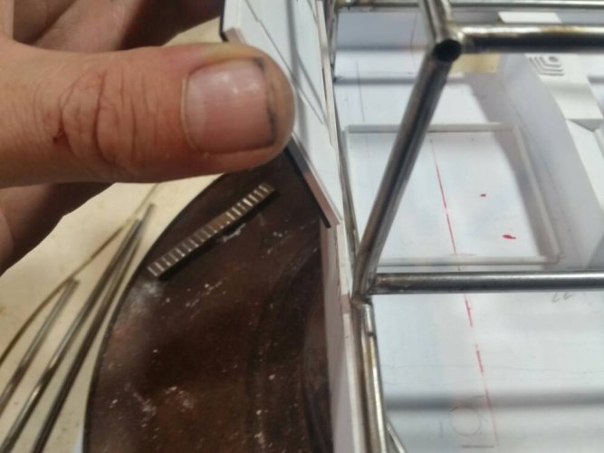

when building the cage i didnt take into account the width of the darn doorpanels i had already made, and the simple little 1/8" crossbraces between the front and rear cage hoops share the same space...
i made the doorpanels really thick so they took up the width of a scale door and not be lexan thin. im going to keep the braces and build a bit thinner door panels i guess. i freakin hope i can get the armrests and windowcranks off.

gotta get some longer coupling nuts from mcmaster and i can finish the skids. i brain farted and brazed too short of tubes onto the skids. take this screw out and the panel drops out from the bottom.
Amazing work. The details in your cage and sliders are awesome.
And I am digging the brake rotors work stand too.
