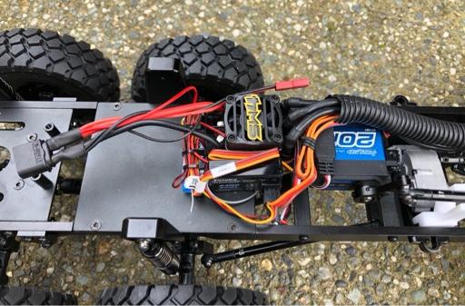

I finished wiring up the ESC, the steering and shift servos, and the motor. The Sidewinder 4 has a foxed 5 V BEC that I’m using for the receiver and the shift servo. I have the ProModler DS470BLHV on a Castle 10 A BEC and a RX bypass adapter with the BEC set to 8 A where the servo has > 450 oz-in of torque and a transit time < 0.12 sec. it can be run up to 8.4 V, but I decided to leave some margin. I added a JST plug to the battery wires for future expansion.
Here’s how it looks after some clean up. This build has a lot of wires! It’s only going to get worse as I add lights and the sound kit, lol!
We fired it up and spun the wheels. No smoke or other nonsense aside from having programmed the Sidewinder 4 for the wrong polarity, which was easy to fix. I also fine tuned the end points for the shift servo. And the body still fits without conflicts with the electronics! Hooray! It’s a little tight once everything is in there ...The ProModler servo is impressive at throwing the front wheels around on the bench. I can’t wait to see how it performs on the trails! There’s no shortage of speed in second gear and fantastic low seed control in first with the HH Revolver. I’m happy with how the build is coming together so far.

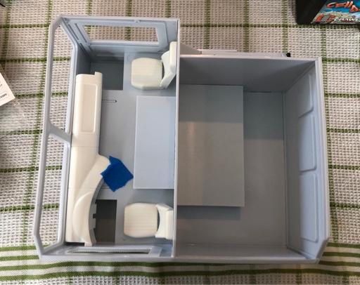

And played around with the interior some more. Thinking I’ll use the dash that came with the Tamiya Scania parts tree with the seats. It fits well and looks nice - I need a driver next so make sure there’s enough room for legs!

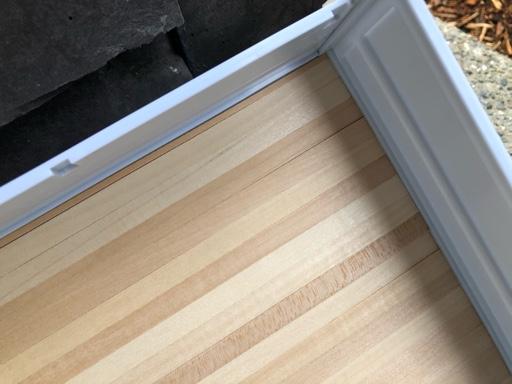

We focused on the wooden bed next. It’s more of a laminate, but close enough, lol! I haven’t done this kind of thing before and honestly, had mixed expectations for the outcome. One bonus for a build thread is you’re free to exclude anything that dings your apparent skills, haha!
The first step is getting some wood. I decided to use 1/16” thick basswood and made a spreadsheet to figure out the width. Basswood is easy to find and comes in a large variety of dimensions that are well matched to RC models. For the spreadsheet, I looked at things like the required number of boards, any leftover gaps, the board width if scaled up to 1:1, etc. In the end, I settled on 3/8” thickness. Scaled up to full size, this is around 5 1/4” ~ 6” which should look reasonable. It’s also only 20 boards which seemed likely to fit within the spare time I have to work on kits!
The mini mitre saw I used for the magnet mounts worked perfectly with the basswood; clean cuts and it was easy to line up the boards for equal lengths. I made each one slightly too long (maybe a mm or so) and then sanded to fit. The whole process went much faster than I expected. Here’s how it looked at the end
Almost done ... except for the spacers on each side, D’oh! The spacers are leftover boards installed on their side (3/16” worth of gap total), which unfortunately doesn’t look super awesome. So much for spreadsheets, lol! But no fear, basswood actually comes in 3/32” width by 1/16” thick strips - one on each side and blamo, no gaps!
Thanks to the magic of television, or in my case delinquency updating the build thread + ordering the magic 3/32” gap fillers and cutting them to length, here’s the ‘final’ product. The 3/32” boards are the thin ones on the left / right sides of the bed.
I’m excited with how it turned out. The boards fit together tightly, but not so much that they want to jump out. I may or may not need to glue them down, but probably will do this anyway.

Next on the list was glueing the wooden floor for the bed. The planks swelled after the weathering and some of them developed twists and other issues. So glue was in order to keep everyone in place.

Few more steps forward over the past week. The front windows and wipers are installed now. I initially missed some of the protective plastic on one and couldn’t figure out why it looked so different than the other one. Doh! Easy to fix at least. There’s not much of an edge holding the windows in. I used rubber cement so it’s easy to fix if necessary. Also installed the front grills. Starting to look more complete!
I also got the seats installed. They’re from a Tamils Scania semi truck interior. They’re a great fit for the Beast II as others have pointed out. It was super difficult to find any when I bought them way back in June 2020. Can’t believe it has taken me this long to get them installed. Better now than never, lol
The seats go nicely with Arya also. I’m planning to leave the side windows off partially so her arm can stick out the side but also as they fit even more poorly than the front windows and don’t actually look super great on the truck.
Small progress on the dash too. I’ve played around with a lot of ideas since starting the build 2+ years ago, including building a dash from scratch. But I have limited skills with scratch building and the Scania dash (from the same parts tree as the seats) is almost a perfect fit so I’m most likely going in that direction. Just need to cut the tabs off either end and cap it on the passenger side. Cutting the tab off the driver side should shift it enough to line up the steering wheel placement almost perfectly.
