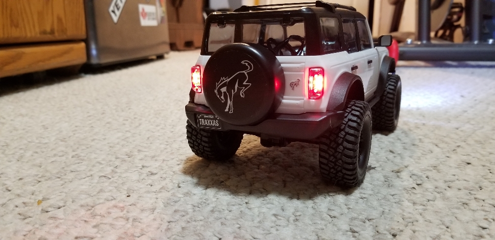

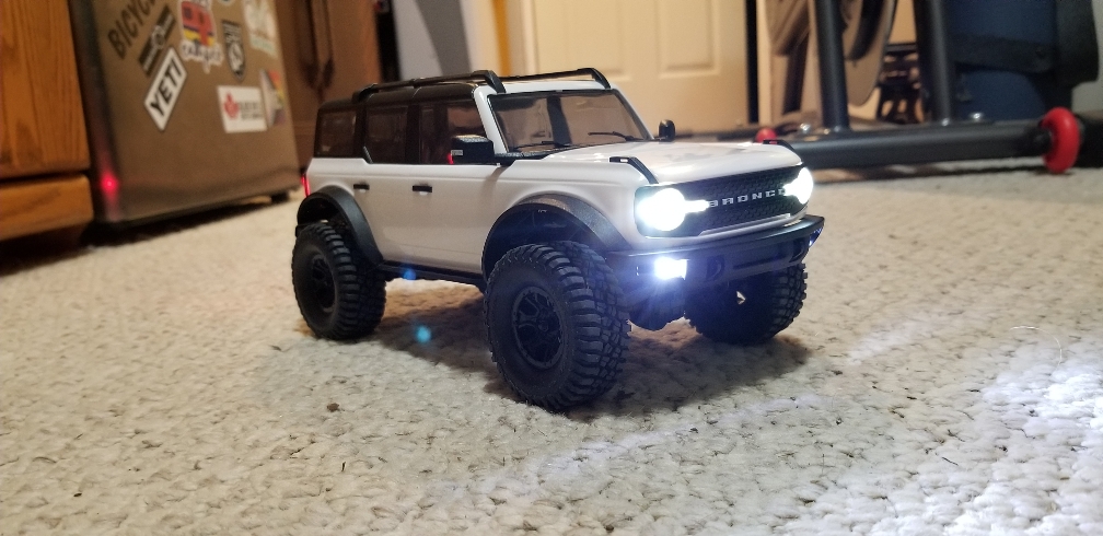

I installed the light kit right away. The kit was well thought out and installed quickly without any issues.
Headlights.
Tailights.

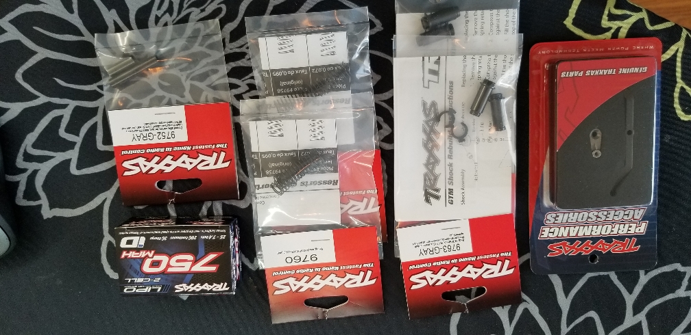

Got a Fast Eddy bearing kit, metal diff gears, steel suspension link (pricey!!). I also bought a set of wheels so I can put a real spare tire on the back.
Got a spare battery, an grey aluminum steering link and shock bodies. I got grey aluminum drive shaft tubes too but it turns out these don't work on the stock driveshafts. Some different spring sets too so I can do a little suspension tuning.

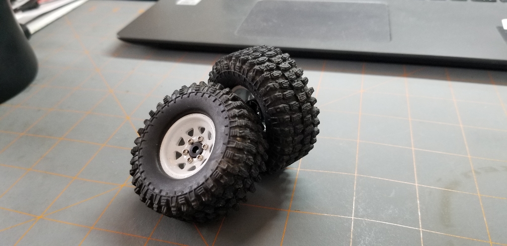

I got the 52mm Chyrax tires mounted to a set of white spoke Injora wheels. Should look okay on the little white Bronco. Nice tires but the rubber compound is a little stiff. We'll see how these work out?

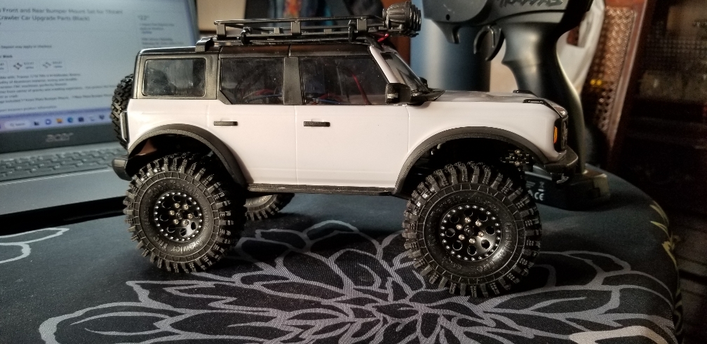

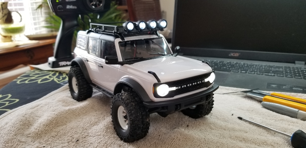

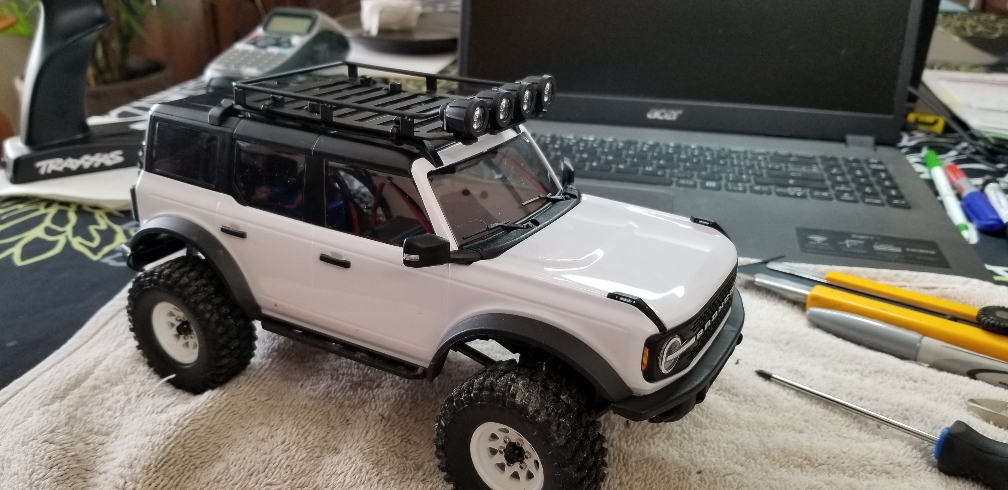

Here's the new wheels and tires mounted on the Bronco and the new Injora metal roof rack. The roof rack has mounting holes in it to screw to the roof but for now I just used small black zip ties to secure it in place. I want to make sure I like it before I start drilling holes all over the place. The zip ties are actually keeping it in place pretty securely.
I'm using an old grubby towel to work on now....wifey is much happier about that!! :lmao:
Ready for the night trails now! I removed the bumper led's as I thought they were a little redundant with all the other lights now.

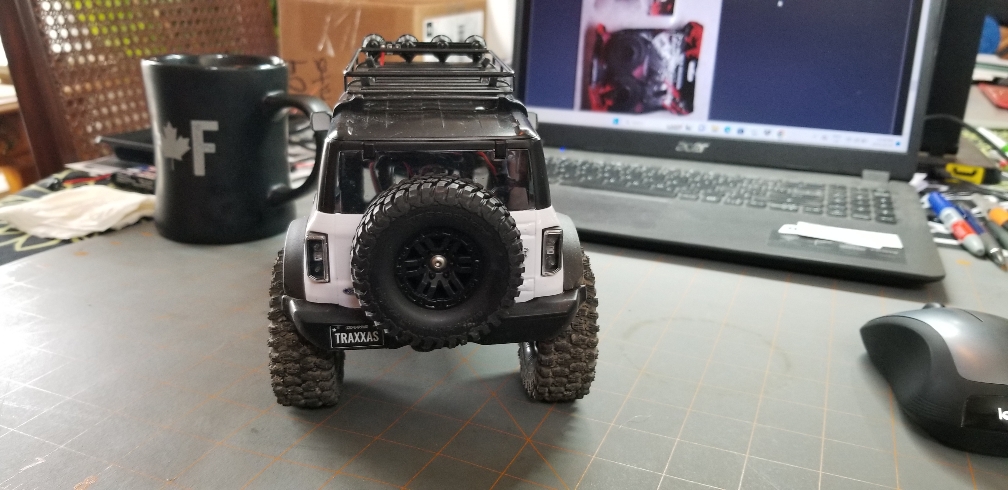

I also removed the plastic spare tire cover and installed a real spare tire in it's place. It is a little bit heavier but it looks better to me and I was willing to make that sacrifice.

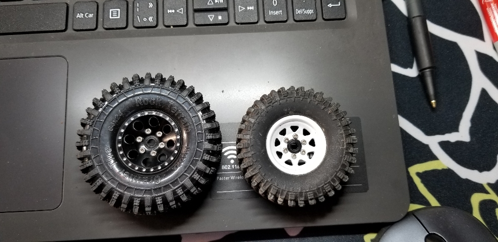

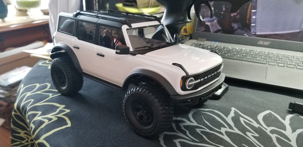

Despite being a bit stiff he new tires are working just fine but I wanted something a bit bigger. I stole the wheels off my Gladiator and mounted a set of 64mm Injora Rock Terrain Crawler tires. These have a tread pattern very similar to the Proline Hyrax tires. You can see how much bigger this set of tires is.
These wheels look really good on the Bronco. I like how they fill up the wheel wells and they also provide a bit more ground clearance. I have another set of 62mm tires coming that I'll put on the white spoke wheels and I'll be able to swap back and forth between the two sets of tires.
