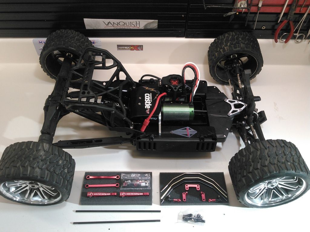

Well as some of may remember a project that I started a little while back .
Project XL-T TWIN 2200 Dragster.

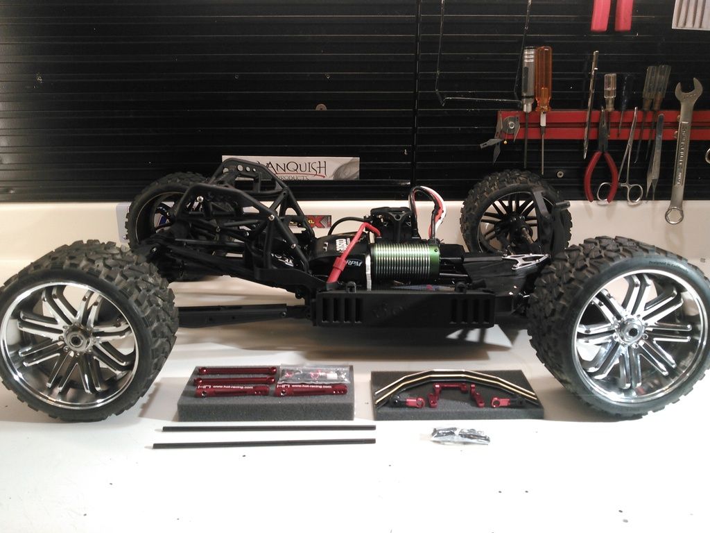

Till I round up enough cash for the 2nd ESC & 6S 5000 batteries, aluminum diff cups/GPM internals /GRP tires/ HD CVD conversion I'm gonna have to settle for one motor .

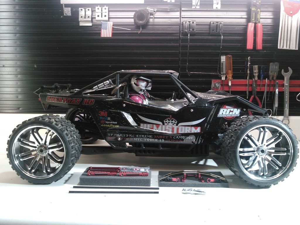

This is the Banshee XL
Thanks again Tphjill for the beautiful HR bulkhead/front & rear track bars !!

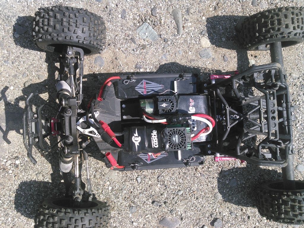

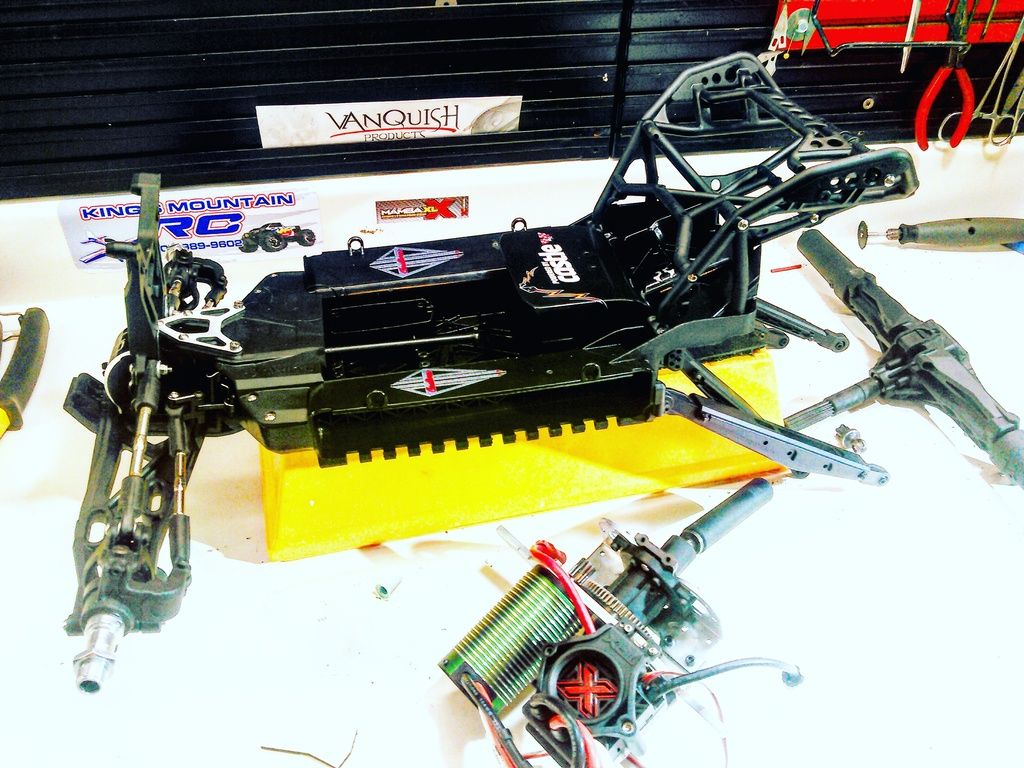

I made the center diff motor mount out of scrap aluminum with basic hand tools. Some of the parts in this build or generously donated by Tphjill !! I really appreciate and admire the generosity and that's why I'm excited for you guys to see what I have to give back to the community"thumbsup"
I was able to re-use the existing transmission holes and add one in the battery trays for tying everything together.
I made this out of some scrap pieces of lexan as a debris deflector.
Got to have a Basher Bar to lock the front down !! Awesome mod !!! Perfect perch for shock tower supports "thumbsup"

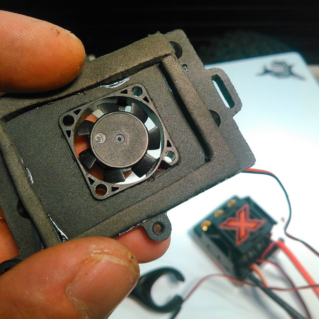

My ESC cooling fan mod

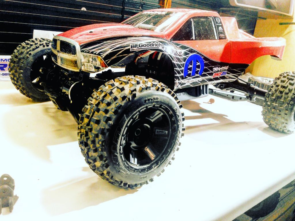

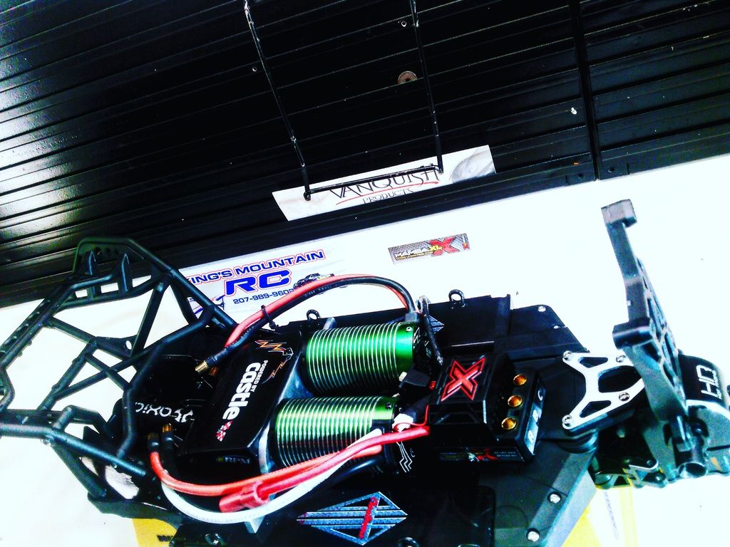

So the big question is shouldn't be a drag truck a pit basher or a trophy truck your guess is as good as mine cuz they all seem perfect.....
This is my current setup Castle XLX & 2200kv .. I've driven it on 8s with out overheating it, but im still going with a TP-Power 8S 2200 motor
