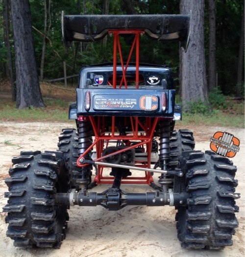

The lowers are 3/16 also. I still may add some extra gussets in there too. I pounded on this pretty good and it took a couple licks.
The rolled tube look got old quick in my opinion. Straight lines are the strongest too.
Couple reinforcements here and there and she'll be in the for sale section "thumbsup"

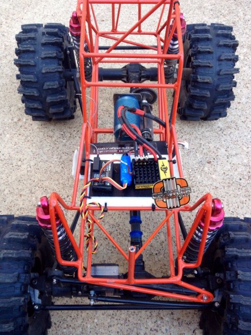

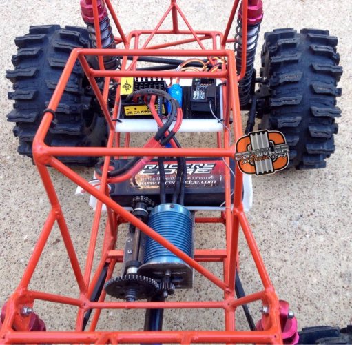

Rig when it arrived:
For electronics I installed:
Castle Creation MMP One cell Esc
Castle Creation BEC
Hitec 7954 steering servo
Generic 1:8 motor
3s lipo
..Uploaded from the lab @ the C.I. Compound...

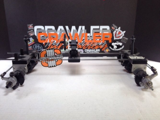

Somewhere in this section is a partial build thread on this torsion chassis I acquired through a customer. Thankfully it had the needed lockers:

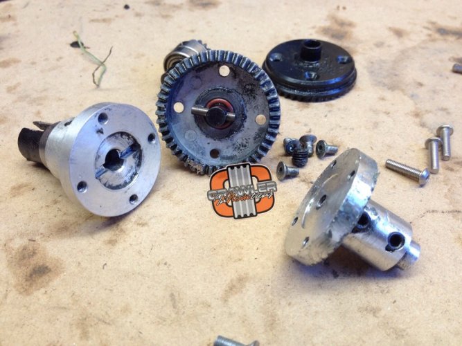

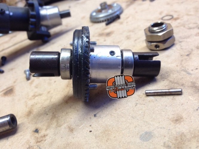

Pic after first run and locker failure:
CDW locker on left, proto on right;
The failed proto parts;
Proven CDW goodness with under drive helical cut gears;

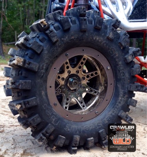

With the axles fixed, it was clear that the stock foams and the high KV motor were not a match. It turns out that our Deuce's Wild 3.8" XL foam; Part # CWR-3009, fits the RC4WD 40 series Mud Slinger Tires perfectly.

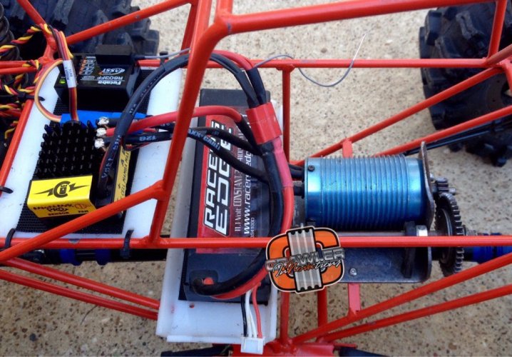

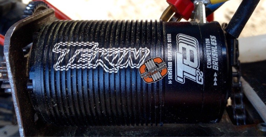

More:
Tekin 1900KV Motor
Rc4wD mud slinger tires
Axial 40 series bead locks
Deuces Wild Foams CWR-3009

Look great! Glad you're enjoying it. What failed the set screws come loose or the shafts come apart? Or both? Just curious.
It was the lockers that failed. Both sides of the locker, front and rear. The shafts you made held up and I kept them and the lockers and may try them in a rock crawler only build and see if they hold up with 2.2" size tires.
