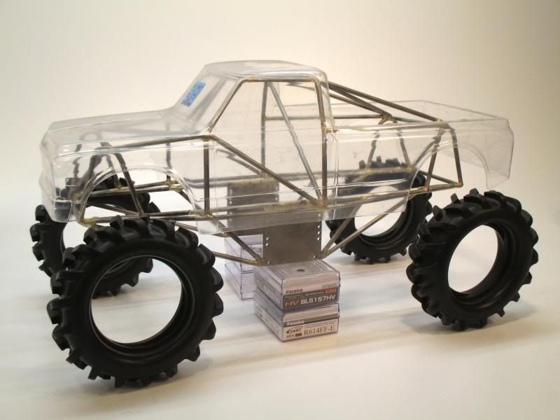

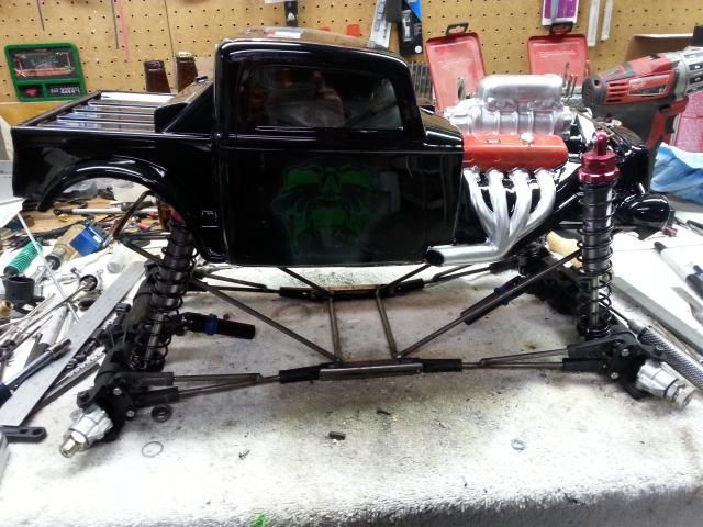

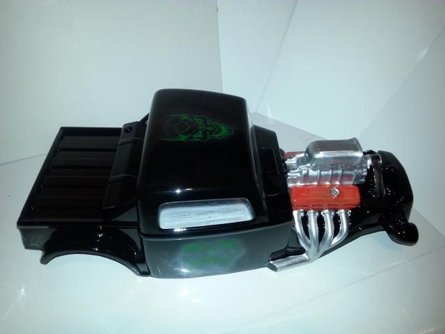

Getting this chassis to fit the body is turning into a chore. The narrowest part is 5" around the engine, and I want the front shocks exposed. I may even need to use my 1/5 scale shocks to make it look right.

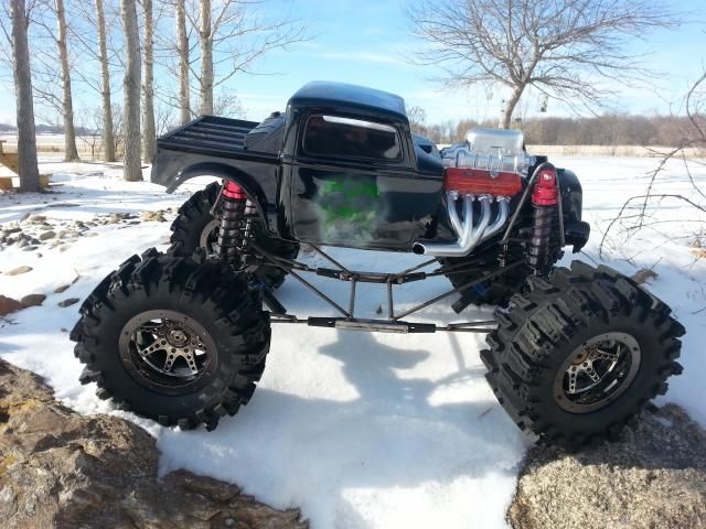

Fab on the chassis has finally begun. I went with a simple ladder bar set up. Not a lot of need for 4 link and articulation here.

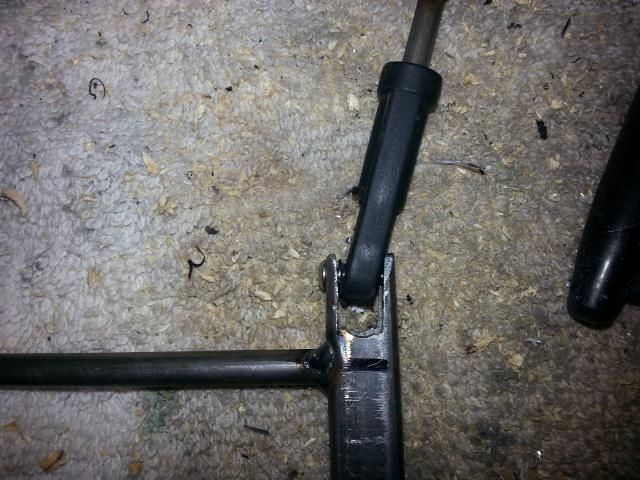

Here is the lower link support.
Here is a basic mock up pick and the look I'm going for.
Front end is pretty much set in this pic. Still need a trac bar but you get the idea.

do you have any concerns about that mild steel where the lower links mount to the chassis bending and breaking?
I added some more bracing in the sides and will add some cage work under the body. I don't want to cut up the body so I won't be able to put too much scale cage into it. It's also cold rolled and I don't want to add too much weight to it.
