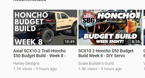

Well thats a triple budget build to follow after Harley and SBG![]()

Some friends and I were just talking about doing this exact thing. I don't follow harley so I didn't know this was going on. Guess we'll have to get on the ball!
Aww hell, the build off is officially next level if White Trash wants in.
