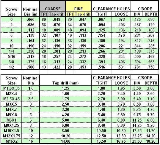

Some helpful tap and conversion charts
2.5 x .45 tap drill is off.. Should be 2.05mm
Nominal - pitch gives tap.
