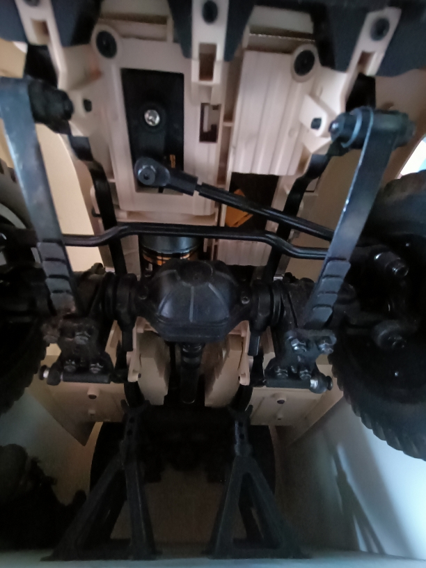

What works on 1:1 isn't always transposable to scale ...
Here's the underside of the Jimny ... the battery tray is on the way, you'll have hard times to get a proper Panhard bar geometry.
On the Willys, it was a completely different layout that had all the room needed for the Panhard bar
Envoyé de mon CPH2211 en utilisant Tapatalk
Fabulous, thanks for the photo comparison! "thumbsup"
It is difficult searching for photos of the real Jeep YJ and the Mashigan, plus the Jimny and others.
You'd think they would be consistent with the linkage and suspension layout. In fact I was thinking
the Jimny and Mashigan would have the exact same layout for ease of manufacture.
I'm curious what will be in the optional leaf spring kit ... according to the manual and the Jimny, the rear inner brackets of the front leaf springs is integral to the servo/battery tray ... however, I haven't seen it on the existing videos ... on some, it even seems to have been cut from the factory ... while the front inner brackets are still there.

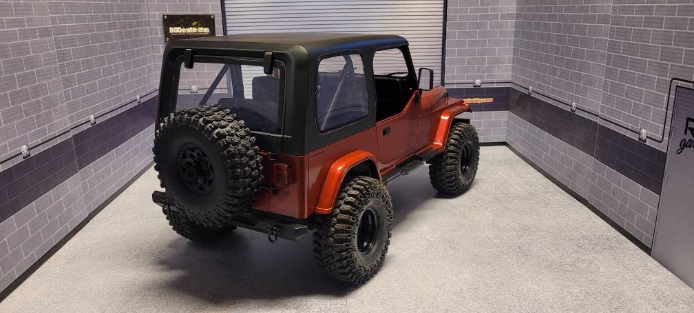

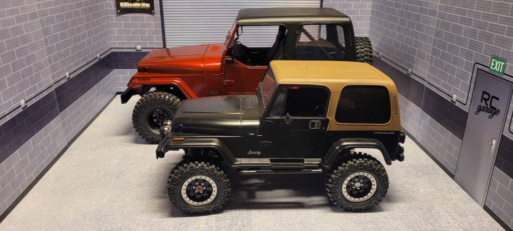

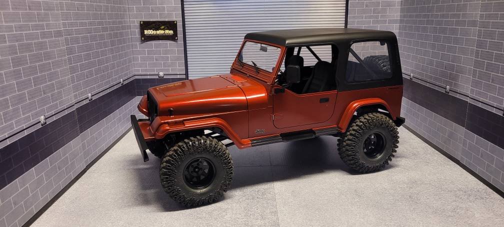

I got mine the other day, body is fantastic really really nice details!20221204_080101.jpg20221204_080124.jpg20221204_080147.jpg20221204_082900.jpg
