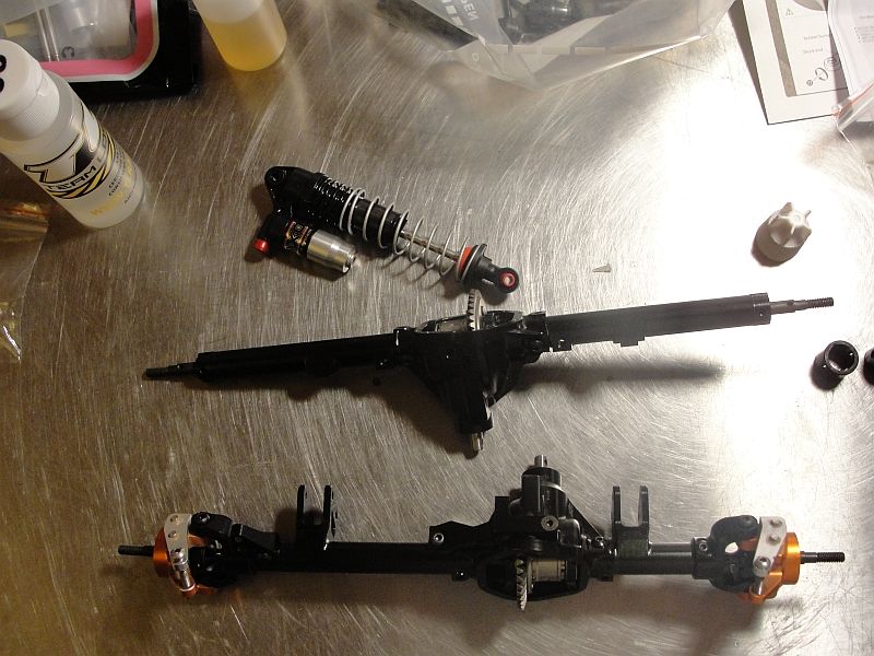

D44 Axle Assemblage!
These are quite hefty in weight compared to the stock Axial housings. Should get my center of gravity a bit lower now that I've added more up top with the wrecker arm. :mrgreen:
I wasn't completely thrilled with some of the axle tube fitmets. The front short tube has a bit of slop when slid into place, but that did disappear once I installed and tightened the hold screws. The front long tube had a nice snug fitment all around. Swapping them side to side didn't change anything. The rear axle tubes were decent on both sides, even after swapping them side to side to double check.
However I was fairly pleased to see RC4WD gave us options when it came to installing the c-hubs. 3 clockable positions (standard option by now) and the choice to use the standard M3 screws, or grub screws to hold them in place. The grub screw option is simply for a more scale appearance. They would prevent the c-hub from sliding off if set to the proper depth (top flush with c-hub.) However I fail to see how they'd prevent slop from occuring in the future, so I went with the screws. Sadly the rear bearing caps did not come with this option, only the grub screws for them.
I did check the drive shaft rotation to ensure these go together the right way the first time. "thumbsup"
One saddening thing I came across is the rear bearing caps themselves. From the factory Axial put 5x11x4mm bearings to support the axle shafts at the ends of the housings. RC4WD saw fit to use 5x10x4mm bearings in the rear bearing caps in order to keep a more scale appearance. Wishing I'd realized that when I placed my order. I'm not saying it wasn't noted, I simply didn't read over the details.

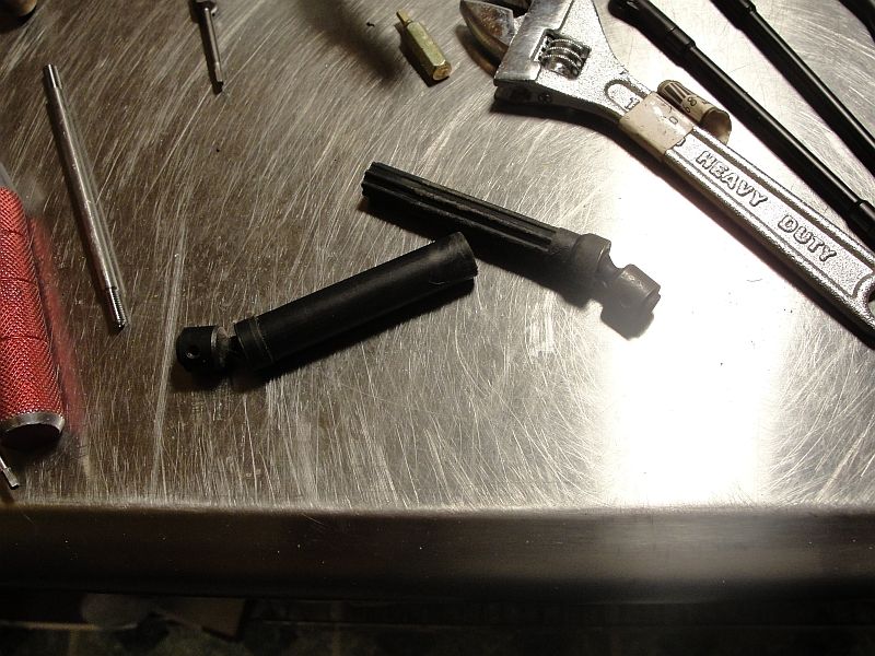

Problem.. Now my front drive shaft is too long, and I can't shorten it any more.
And this is why you keep old parts..
A set of Axial plastic drive shafts I can cut down and use till I order some shorter MIP's for the front.
