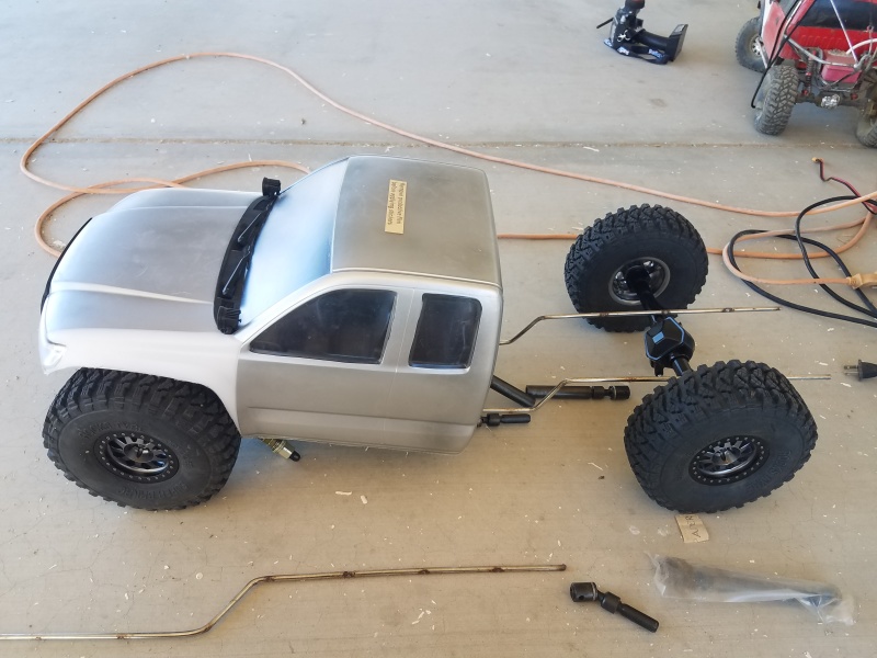

im using 1/4 inch steel rod recycled from some kind of shelf unit so im saving about $150 by making my own cage from scraps and not buying the frame rails or the bed cage

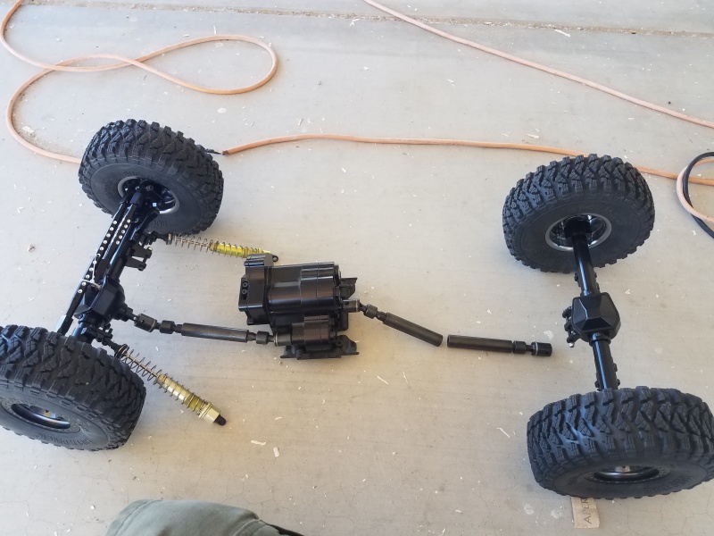

Axles should be here in a day or 2 then i need some drive shafts so i can set the wheel base and that will tell me were to place the skid on the chassie then i can start welding up the frame and rear cage

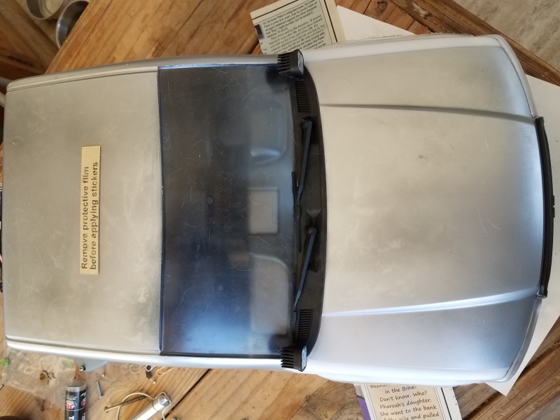

I got the inside of the body painted the provided masks suck so I used masking tape but I did use them on the lights and sure enuff I got some bleed though not to big of a deal but kinda bummed me out
The front fenders I painted white to give that fiberglass fenders look when the paint scratches
The rest of the cab I used a vary light coat of silver and backed it with some gray primer it's not vary uniform but it's a underlayment and will look just fine under the scratches

Anyway the drive shafts showed up in ordered 2 sets cause I want a longer wheelbase than stock so I bought a extra set to make a extra long shaft then I can set my wheelbase were I think it should be and start on the cage
I'll post pics as soon as I have something to take pics of lol
