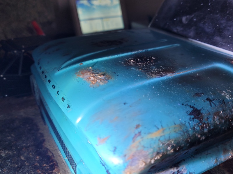

i got this body with a chassis I wanted for something like the body is in good shape but the mint green isn't polycarbonate paint and is flaking off pretty bad so I decided to run with it I hit it heavy with clear and superglued all the flakes I could
I figured it's a good excuse to patina it and it's gonna go on this chassis
i figure since it's about 3 times lighter and not nearly as tall it should be a good performance upgrade
