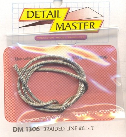

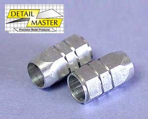

A/N Fittings and scale braiding
After searching for over a month another 6 hrs
Finally found multi scale A/N fittings and braiding from .20mm to 2.5 mm "thumbsup"
Lots of motor , brake, fuel line parts
http://www.hiroboy.com/catalog/index.php?cPath=47
There is a shop in USA who actually makes this stuff but I could not find the larger size stuff on his site http://www.detailmaster.com/
