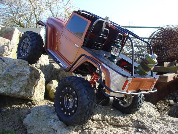

To make a nice looking bed cover, use some 1/8" ABS plastic, the plastic I picked up had a nice texture to one side of it. It also cuts very very nicely with the plastic blade I have for my dremel (couple of dollars, the cut off wheels will melt the plastic and make a mess!)
It can also be used for lots of other things, I used it to mount the seats in this land cruiser as well.

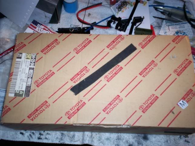

STep 4: Carpet, whats a scale rig with out some sort of carpet or flooring?
I took this here felt kit home from the Toyota dealership when I was a tech, it has stick on felt used for fixing dash rattels in cars OR subs for carpet in your Bruiser interior :mrgreen: im sure you can probably pick up something similar at a crafts store.

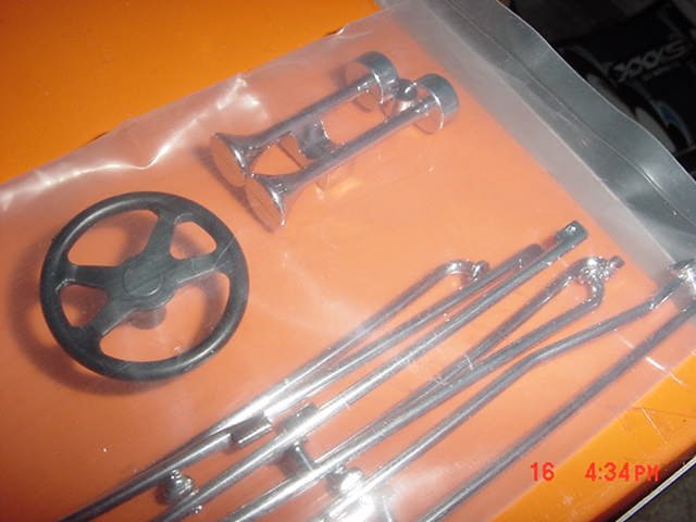

Traxxas part number 1517 contains chrome bed rails, air horns and a steering wheel. Five bucks :mrgreen:
It's off the Villain IV electric boat. For reference, the steering wheel is about the size of a quarter.

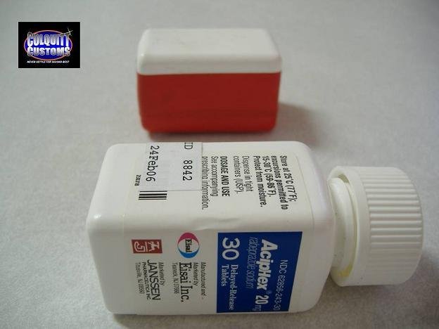

Scale Acessories
Picture #1 Need an icechest?I used a bottle of pills for mine.Cut the neck off and just wrap the bottle with electrical tape.If you're really dedicated you can fill the hole and paint it.
Picture #2 Need an Igloo water jug?I used a cap from my wifes lotion.Painted orange and the top white.Looks like the real deal.

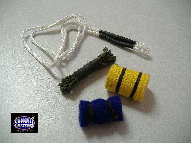

Picture #3 Need a sleeping bag?Get a peice of webbing,cut it to size and wrap it up.Make secure straps with thread or tape.Tow ropes and regular rope? Use nylon and put heat shrink around the ends.I use a thicker nylon for my tow line and a smaller one for etc.You can find pretty much all this stuff around your house.
