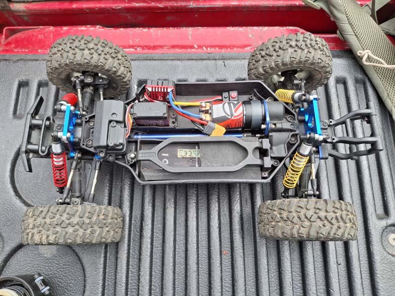

Finally got this one buttoned up. A slew of little parts that I was waiting for came in and I quickly got to work..
First thing to fix was the rear toe issue. The chassis has 2d built in, I had 2d on the arms, and apparently 2d on the hubs....so I had about 6 degrees total. Yikes! I ordered the 0d drag slash arms and found some 1.5d hubs in my stash. The rear Slash hubs would have worked from a toe perspective, but they were too tall and the upper link hit the body. The smaller 1.5 hubs (not sure what they are from - 4Tec maybe?) solved all those issues. BUT they are slightly narrower and left a lot of play at the stub axle. I eventually drilled out a few random washers to act as spacers.
Well, that sucks...
New shorter rear hubs, with a large gap between the hex and the hub. Nothing's ever easy... :)
Holmes 550 21t for power. I didn't want anything too high power as my crawler batteries are generally 25-30C packs and I'm a bit concerned about the amp draw. I think I'll be OK with this setup. I geared it fairly low for a lot of low end rip. I found the radio box a bit late, eventually I moved the receiver into it and it should be ready for some wet conditions.

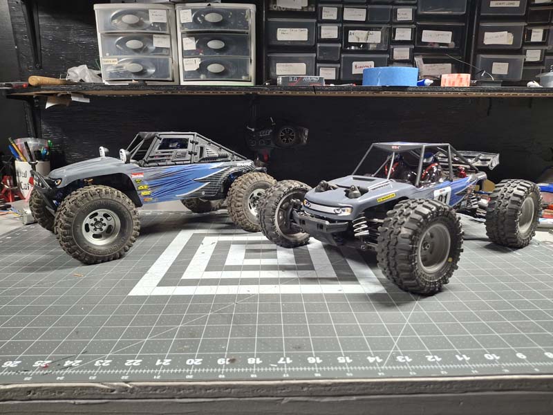

The Telly is back!
Bashing around was fun, but I wasn't crazy about the wider stance on the crawler so I tore down both chassis and swapped the Bandit arms back to the crawler truck. I swapped over the body and bumpers too - they are lower and lighter and I like the look better. Even the wing...why not? :)

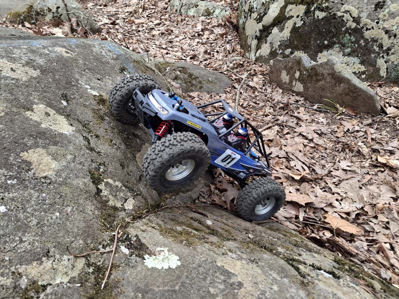

Really struggled today. I had a somewhat stiff suspension and some new tires with dense foams and I couldn't seem to get grip anywhere. Pretty disappointed with how it ran to be honest. Plus the noise from the Castle ESC and Holmes Outrunner was just too much.
Still sidehills nicely, but that's about it.
Going to get a new motor, shocks, and foams. Much more performance to be had here.
