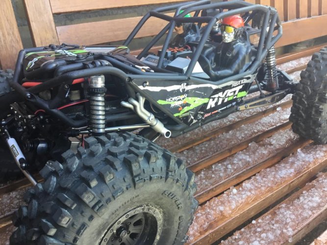

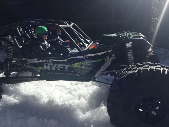

Got the LMT exhausts fitted. Shame I had to cut some of it off.
(Sorry about the quality and the huge flare. Sun jùst came put after several bouts of hail and snow ( yes, really.. )
(By the by, fitted a 6cm RC4WD LED bar at the front. Bit fiddly, but once in.. my word.. O_o now thát is ‘lighting’ eye-searing on only the 6v out of the RX.. )

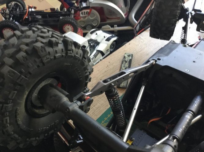

By the by, for those that bent the rear swingarms: Integy rear swingarms for the Yeti fit with a bit of fiddling. Fixing the swingarm support on the axles upside-down, makes up for the somewhat shorter length. Still a bit shorter than stock, but it kinda looks ‘right’ now.
