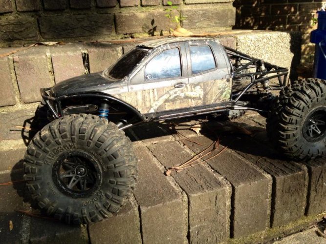

I took my "go fast" apart and used my spare parts to build an Axial based shafty. It crawls pretty damn good. I have a few things I want to try and since Losi parts are getting hard to find sometimes, this is the result. I'll post more detailed photos later.
11 1/2" front
11 1/4" rear
I did this cause I was bored with the go fast but this thing really performs. I might try it at a comp, don't know. Just like to tinker with these things. Sid drove it tonight and either he's improving as a driver or the rig just works. Probably both...."thumbsup"
that's close to a half inch on the wide side of things up front...but not ridiculous. If you could pick up a set of RCBros knuckle weights for it and use a set of the DE Racing plastic wheels you could set the width narrower and lose weight at the same time. Of course if it's working for you as it sits...dismiss my rambling :ror:
Good suggestions. The XR wheels are all I have at the time so that's why they're there. Plus I can use the VP weights with them that I've had forever. It is a little heavy at 5.4lbs, but that's close to what I am used to driving. It needed a little more weight in the front than the Losi for some reason. Maybe because of the ultra large and heavy MMP esc that's in it. By the way, you got a good 27 to 35 turn brushed motor you want to sell? I've got the Tekin 17.5 brushless in it now (had the 13.5 in it but it was too damn fast). I have a spare FXR and want to use that because of size, but need something faster than a 45 turn. The drag brake situation is what is so different about driving this compared to the Losi. Other than that, they perform close to the same.

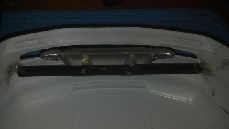

Got bored the other night and fabbed up the FMIC to the Skyline. Not the best job by any means, but it will do the trick for now. "thumbsup"
