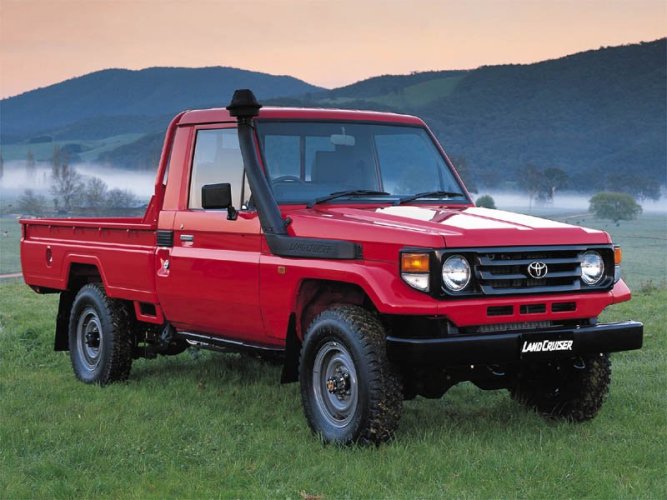

Anywho, time for the update. I have ripped out the old grill so that I could build up a new one based on the real-world Landcruiser 78, the last model that has the signal lights like this body has. I think it is mostly there, but I need to do a slightly better job matching the two sides up. Check out the 1:1 against the 1:10.
I have also enclosed the signal light "buckets" in preparation for adding lights. And speaking of lights, the grill will be fitted with, like so many other trucks on RCC, a set of Axial light buckets and lenses.
