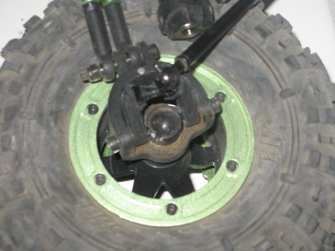

I broke a c hub due to the shaft failing i can figure out how the shaft broke or how the pin caused this much damage.
C hub break
I know how u feel i broke mine also in first 20 minutes of running been on shelf for 4 weeks now waiting for parts order them from tower they seem to have everything good luck with it
