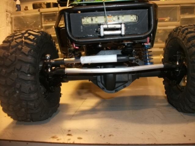

I got my housings and other goodies yesterday. Spent NYE in the shop. Man I LOVE these axles. The gears sit so much better in these than the stock SCX axles. Plus with a little LURC hardware they look the part as well.
Vvds to I'm guessing? Are you running these axles? If so what do think of them over aluminum vanquish or the ssd diamonds?
Done , steering hooked up and XVD installed. The fit and finish is great , love the new look the gave my rig also. I don't think i'll ever buy a stock axial housing again. "thumbsup"
Yes, forgot the VVDs fit and are in my setup. Better than VP aluminum, slides over rock better and cheaper. Havent' tried SSD Diamonds, but they look nice.
