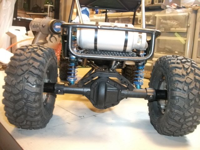

Here's my slightly shaved housings
Ya I guess I should have done a before an after. I removed the gussets on bottom and smoothed out all the corners and edges.

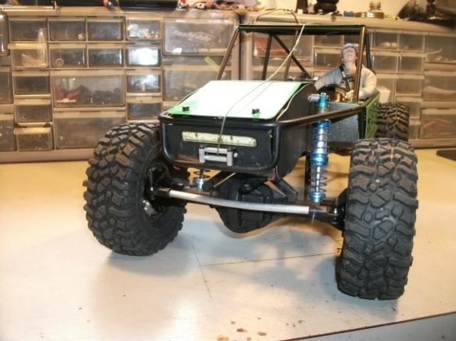

I worked out a deal for this new set , Just installed them today in my Ftoy with a set of king shocks. The fit and finish is perfect.
