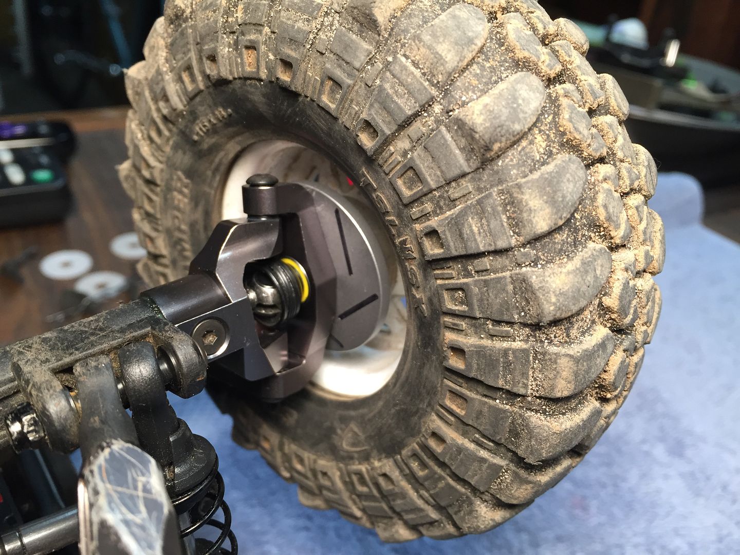

Four wheel disk brakes painted and installed with new Vaterra machined aluminum rear lock-outs, c-hubs, and knuckles, all very high quality parts! I used all new AvidRC rubber sealed bearings, the old bearings were getting gritty from lots of dirt and water crossings. Used a new set of four little steel 'hats' for the knuckle pivots screws, the original were pretty good only couple thousandths worn (still fit better than most other brands new parts) but I had new, so use them with the new aluminum parts. The rear lockouts and front C-hubs fit so snugly that I lightly greased the outer ends of the axle housings before installation.
