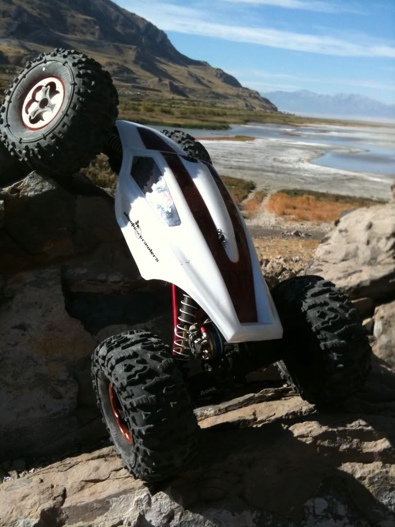

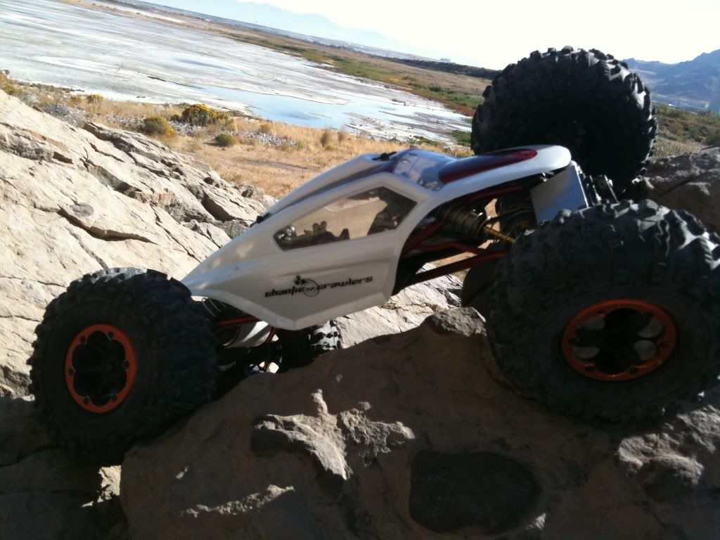

Here are a couple pics I snapped today.

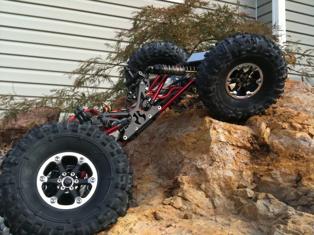

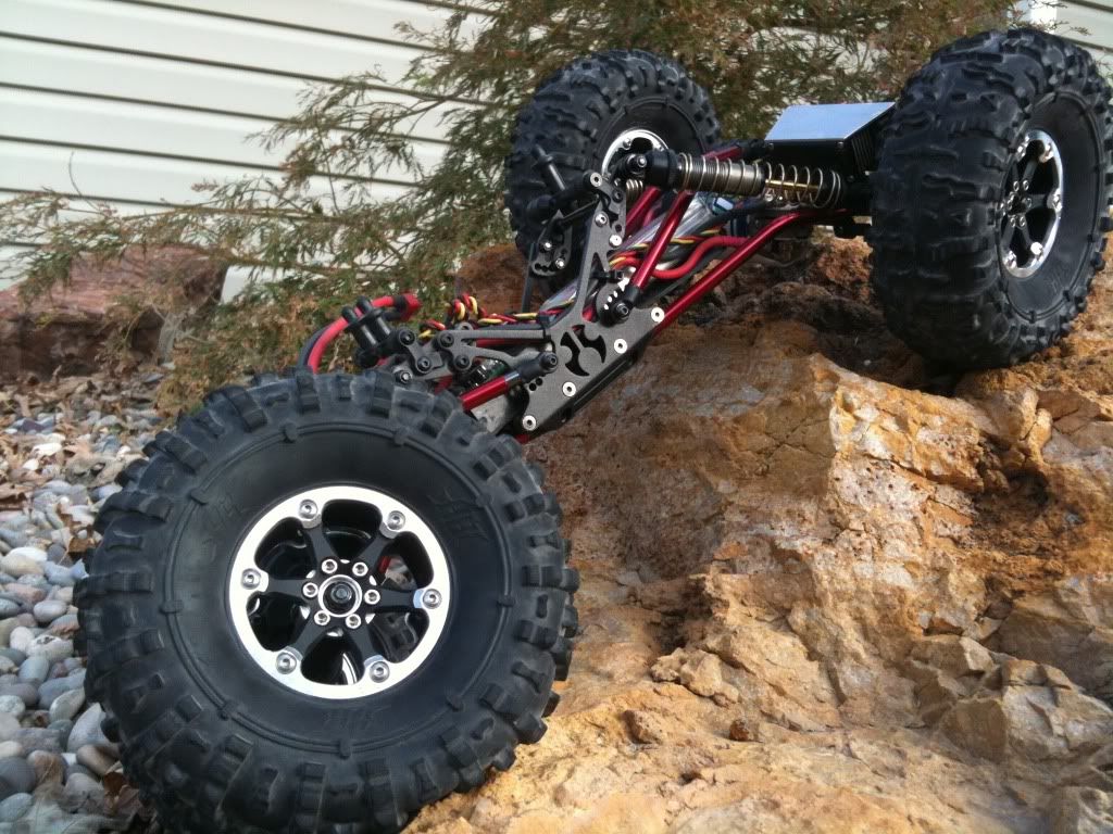

I upgraded to titanium steering links with traxxas rod ends, this upgrade along with the aluminum parts took basically all the slop out of the steering.
I trimmed my nova inner foams down from 2" wide to about 1 3/4 wide in the front, and Added 8oz. Of weights.
Total front wheel weight is 13.8 oz each.
I didn't weigh the rears, but I figure they didn't change much from the stock wheels. So we will guess 6.5 oz each
.225 hubs in front
.350 hubs in rear
I hope I don't have to add much more weight!:|
Onto the pics.
the servo armor is available from www.chaoticcrawlers.com
the rig did great today!
I killed all the hardest lines out there with ease.
I am trying to get used to it being so light in the front though.
it can make the really steep lines, but you have to finesse it to goup some of them.
I would like to get another 1/2 to 1 oz extra per wheel in it.
I also noticed it trying to unload the high side rear on some really off camber sidehils, that my berg would just walk across it.
I think I can cure that with link adjustment and shock tuning though.
I was about to switch my pack and try one more set of ridiculously steep lines when I dropped it off a couple inch ledge and the rig flopped on the landing and started into a roll...
well, I broke 2 gears in the front axle when the wheels hit the rock!:cry::cry:
I was surprised because it was such a small and simple roll when it broke!
but I guess I'm not really that surprised in the end!
but all my bearings are still in good condition!:)
all in all I'm very happy with the stance the rig has and it's capability is exceptional, the lighter weight really allows you to get it into some crazy places!
