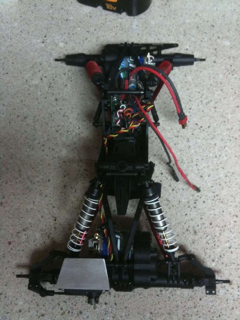

Here is how I started my night.
I will spare you all the build
Pics, because by now you all know what they look like.

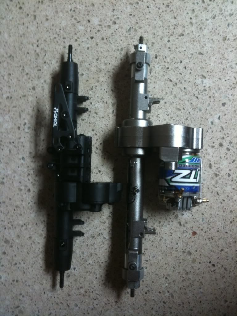

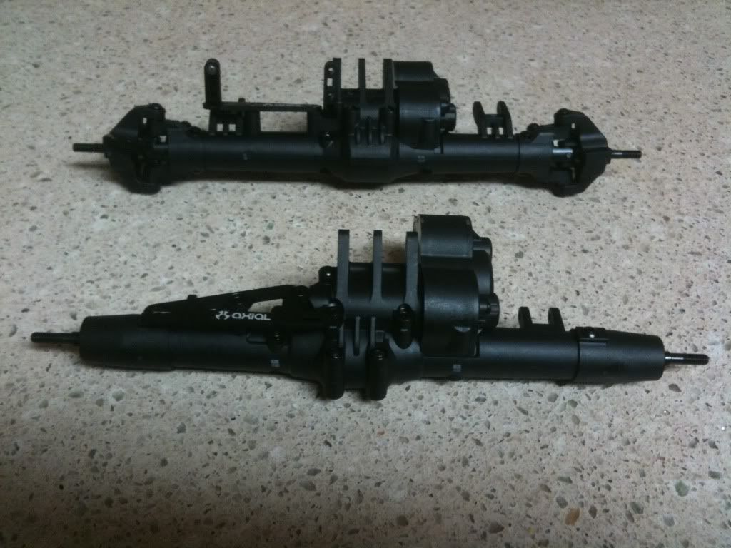

Here are the axles all
Completed.
And compared side by side to my old berg axle.
My original thought when building this was to just bolt the axles up to my existing rig. But I had my doubts on whether it would work.
Well... I was right. They did not fit well at all without some serious modifications.
So I prepared myself for a long night and got to work on the rest of the rig.
So far I must say, axial definately has some time and thought into these axles!
The plastic they used feels better too.
My only complaint is that they still used 3mm rod ends. Even thought the rod ends are beefy.
I know I'll still break them.

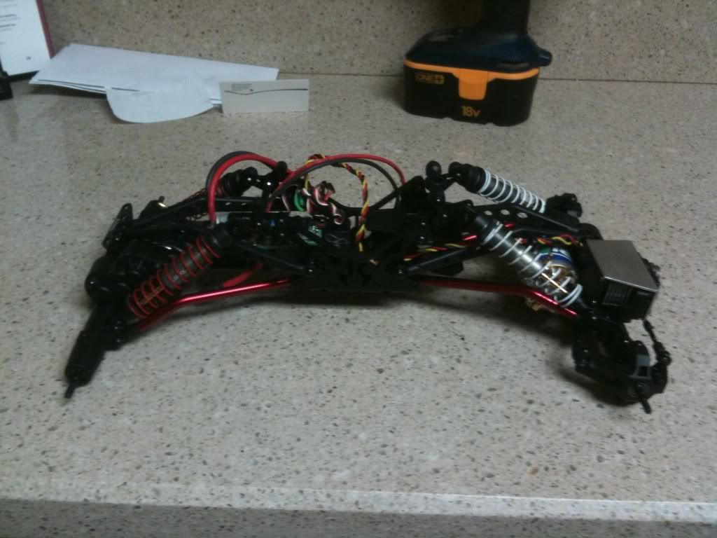

I've got it all finished minus the wheels and tires at the moment.
Sorry for the awesome pics.
Your stuck with crappy iPhone pics at the moment.
What springs are you running? Front looks like stock but not sure about the rears...
The stock springs are way to stiff for my liking.
So I swapped them for some losi springs.
These are the springs I've always ran. So I'll have a more familiar spring setup. This way I'll be able to tune the suspension a little quicker to my liking.

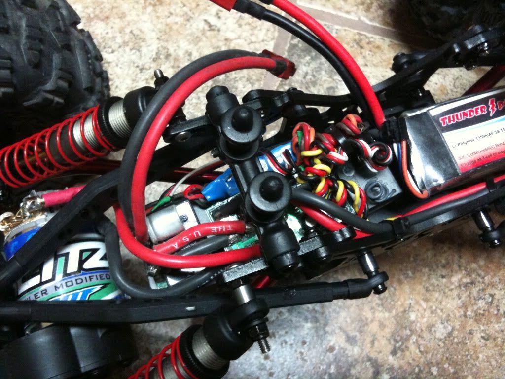

I've been tinkering with my xr10 for the last week or so now!

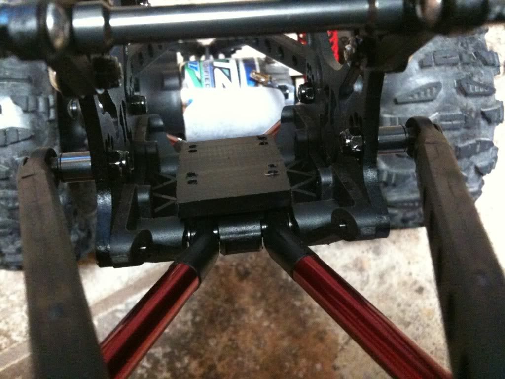

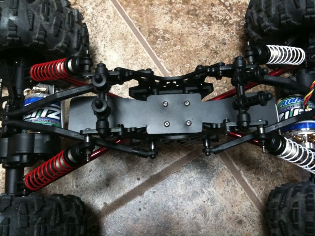

I wasn't a big fan of how my electronics fit into the electronics tray, so I made my own plate.
I found that the plate had to be spaced about 1/4" up to clear the lower links.
I was having a hard time finding a way to mount it without using nuts.
I started going through all my old chassis's and found an old skid plate from a mini niño chassis.
This worked out perfect.
I then beveled the front edge to allow
Extra clearance from the link rod ends.
It's hard to see in the pic though.
I then made an electronics plate from .080 styrene.
Then remounted all my electronics back into the rig!
That looks awesome! Great job on the Electronics tray. What are you running for lowers?
Wow! I'm loving that electronics tray. I assume it doesn't bind with anything right? Is the styrene you used floppy or is it pretty stiff? I'm thinking of doing something similar maybe with carbon fiber once I get my XR10
That electronics tray is awesome. I'll have to try something like that myself.
When the styrene is atleast .080 it's not floppy at all.
I just bought some .090 delrin that I'm going to try out next, just to see the difference.
But the styrene is plenty strong and that's what I've always used.
The plate doesn't bind at all, I spaced it up 1/4" to make sure everything cleared because I found if it was mounted directly to the skid the links still wanted to contact the battery when articulated.
