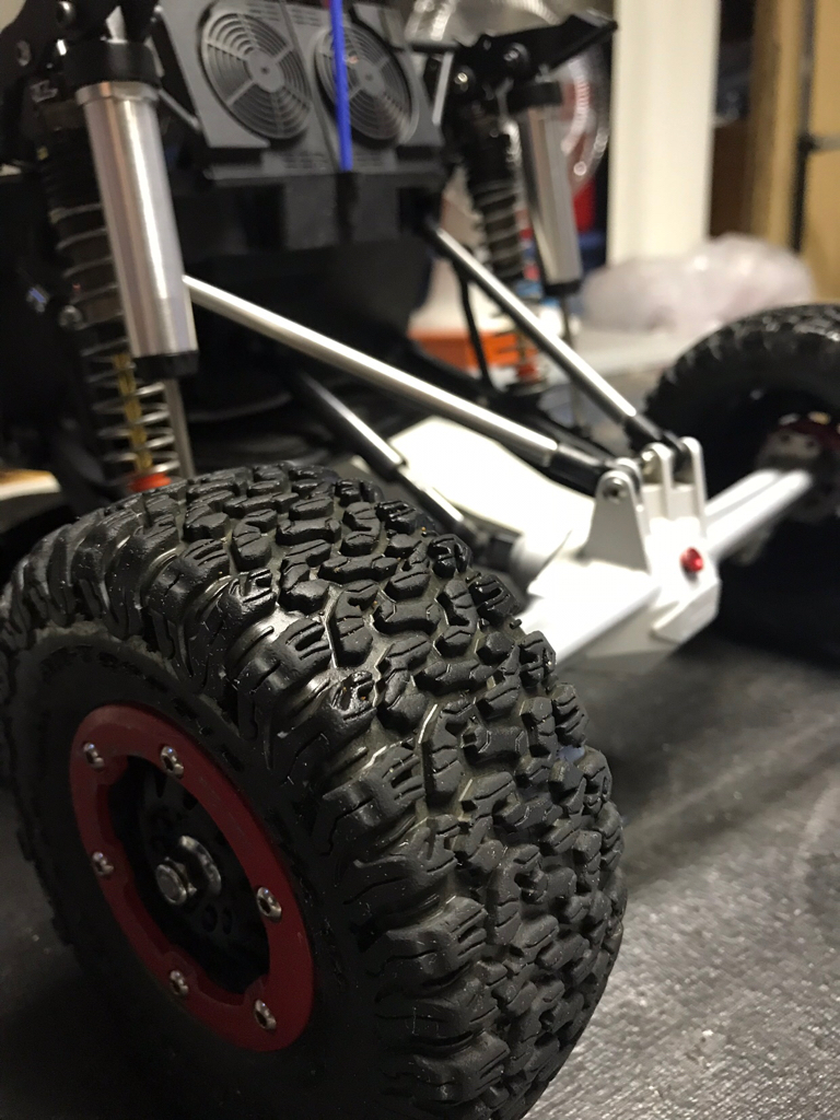

Someone needs to come up with a high quality spring steel oversized shaft version, direct fit, my u-joints where totally fine the shafts were just noodled. I wonder if you could take the diff outputs from the Rock Rey and use those to adapt the Rock Rey sliding shafts?

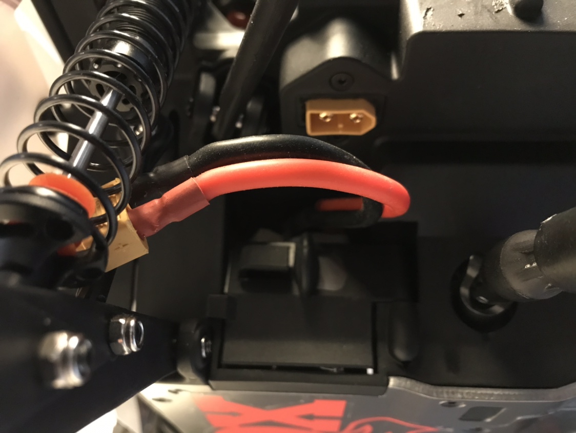

Hi guys! I have ordered a Baja Rey bnd and ride version without the Fuze electronics. Will use my HW EZrun 120A Max10 esc and HW 3660 motor. Question: I’m not sure if I can use XT60 connectors (that I like). Hard to see in pics. My other question: will the box also contain a lower geared pinion? It’s a 5mm m1 pinion right? Thanks
Verzonden vanaf mijn iPhone met Tapatalk
Got the xt60 question fixed.

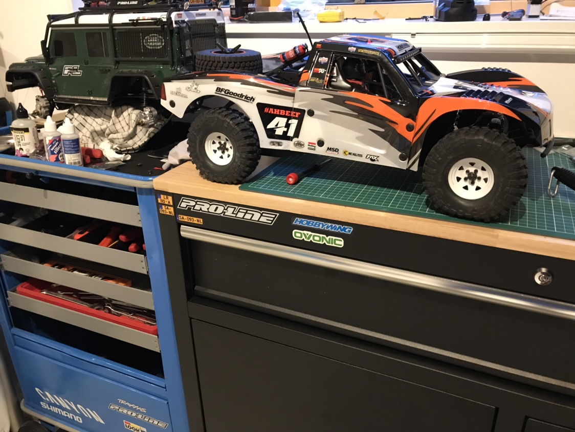

I have the truck since yesterday. Built it and it runs amazing. Also replaced the servo with something stronger and quicker that I had lying around.
Also worked a bit on the body and interior.

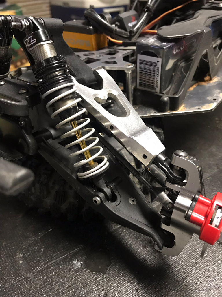

I took the truck for a quick test drive in my backyard to make sure all was well before I put the body on. My boys brought their Slash's out too, so we made a small loop with a plastic skate ramp (table tops) on each straight section. I was pretty pleased with my minor changes to the suspension and was running pretty quick for such a small area, but then... I got a little too frisky and waaaayyy overshot a jump, landed (on the brakes) and wadded it up. Now the servo is making angry noises and does not steer. I opened it up and cannot see gear damage anywhere, but I'll need to spend more time diagnosing that.
That servo is probably worth fixing (2+ year old mid-range Promodeler) but I've got a 4 pack of DS3218 "Pro" servos on the slow boat right now (ordered 2 weeks ago) that seem like they'd be worth a shot. Specs say 23.5kg/.09s @ 6.8v, so I'd imagine the speed will be tolerable at 6v.
