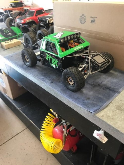

Quick shot with one of the old cabs mounted. I also went ahead and buttoned her up with all the inner panels since everything seemed sorted.
Waiting on the new RPM decals for the new body. Gett'n close!
"thumbsup" Looks good! Can't wait to see all finished up.
I just stumbled upon this thread, 95 pages deep. Some nice looking rigs, gang. As for paint schemes, McMillin has a Mason MS awd truck as well, and cool graphics. Out of curiousity, how many of you guys are running Metalconcepts parts? mewalsh100, how much does your truck weigh with the metal cage? 10 lbs? Looks great! "thumbsup" I'm also curious as to how long the paint will hold up on the wheels, mine are kinda hammered from rocks so I haven't painted them. They look like a million bucks with color. All good for contingency.
I’m running MC upper and lower control arms. Vanquish Currie F9 rear end. Truck weighs 11lbs with 3s 5000mah pack. As far as paint on the wheels, they’ll probably get torn up pretty quick. I’ve got several sets of other wheels that i’ll most likely use for runners and reserve these for shelf queen status.
