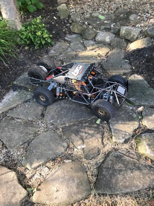

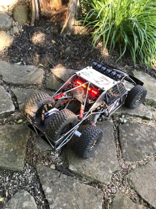

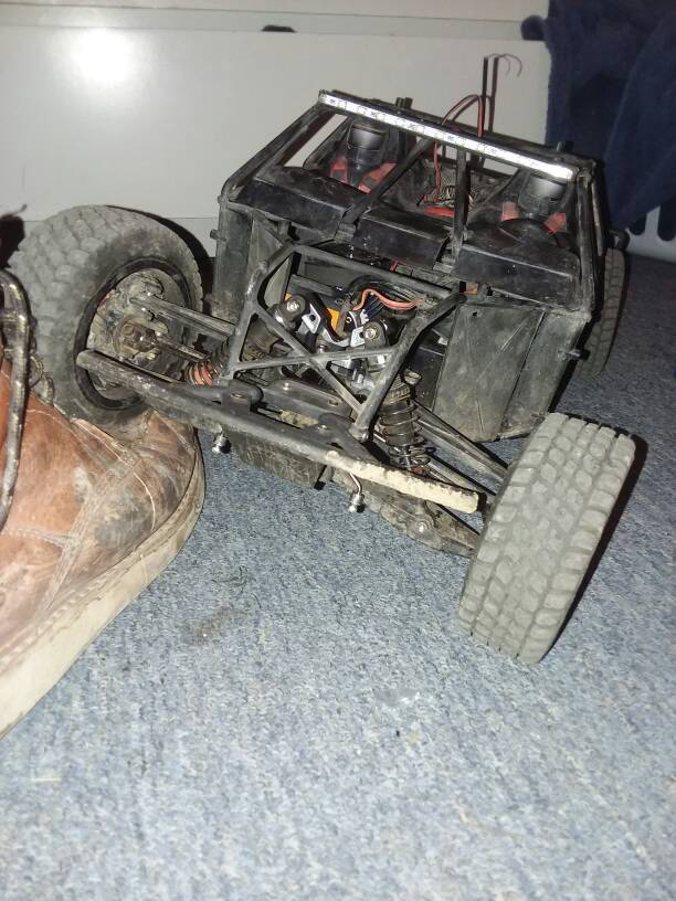

She's ALIVE! Drove under her own power for the first time tonight with the new metal chassis / cage. I still have a lot of detail work to do, little odds and ends, but I'm stoked! The HH 4100KV PullerPro is a monster!:shock:
Coated the chassis with Steel-It coating just like many of the 1:1's get. I can't say enough good things about this product. The finish is awesome and looks very scale.
I also got my light controller installed so I can turn the running and chase lights on and off from the Tx."thumbsup"
ESS One engine sound system is also installed and sounds freak'n cool under power!
I've got all the inner panel skins done from a while back, but I'm going to leave them off until I'm sure I've got all the bugaboos sorted.
The Proline PowerStrokes feel pretty good straight away, especially at the back where I ran a dual set up. The fronts are a little under sprung, but I've got a spring assortment to play with for that.

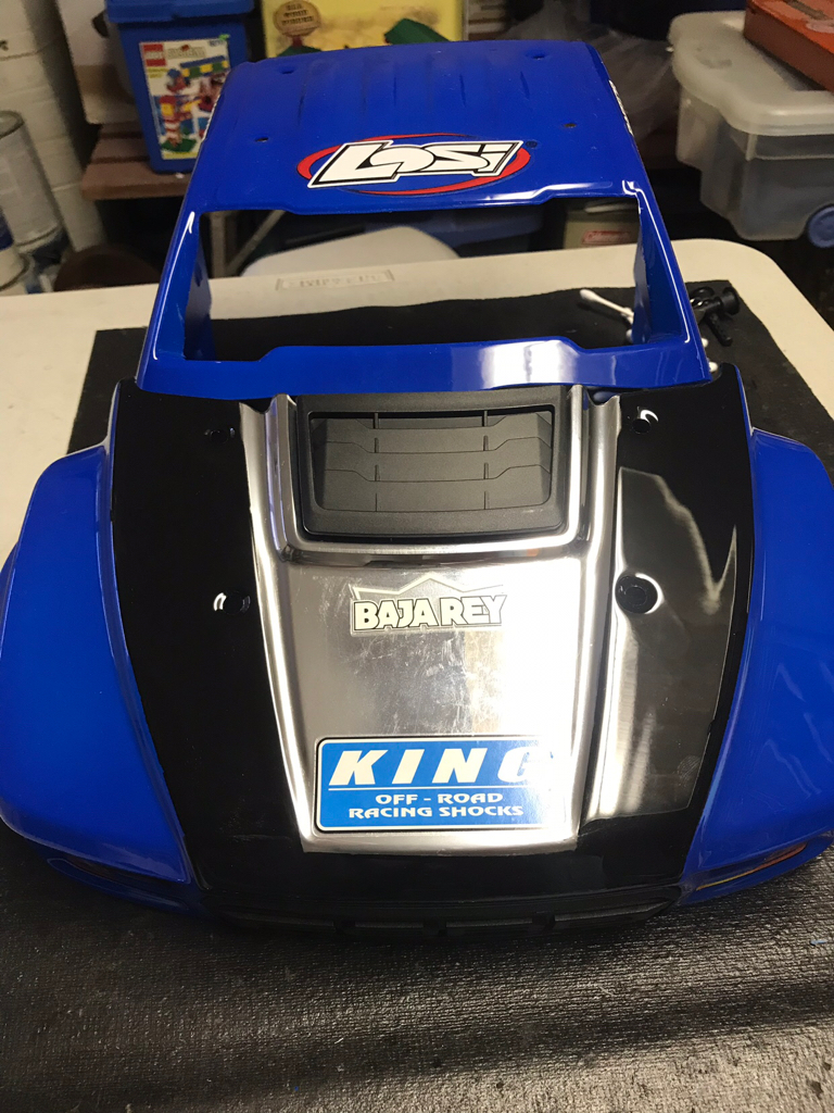

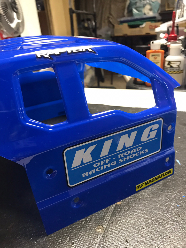

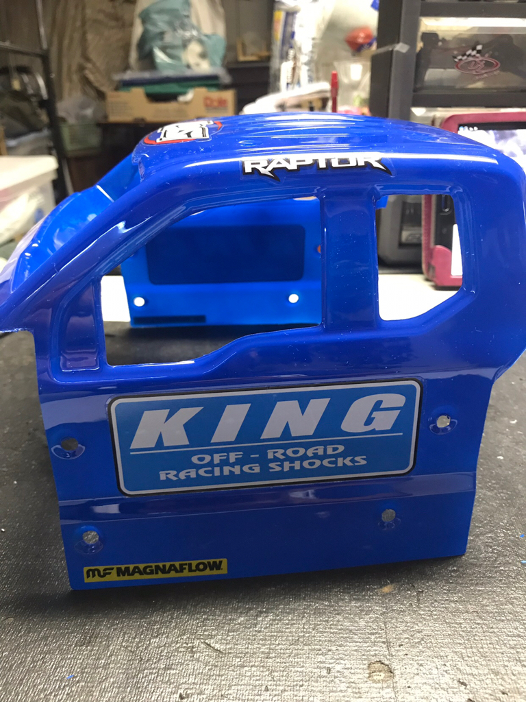

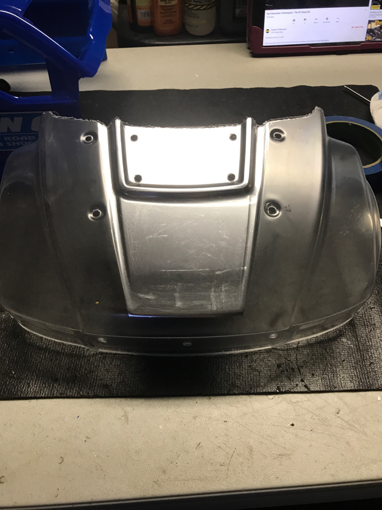

Last, I've got the body prepped and trimmed up to fit this cage. I'll be doing RPM livery. (Gave my driver and navigator orange suits for matchy/matchy to the body:lmao
I purchased the RPM deals from MCI racing in Canada. I popped the little bit extra for the reverse adhesive so the stickers will actually go on the inside of the body, then painted over. I'm going to try and get the body sprayed this weekend and work on a few more scale details."thumbsup"
