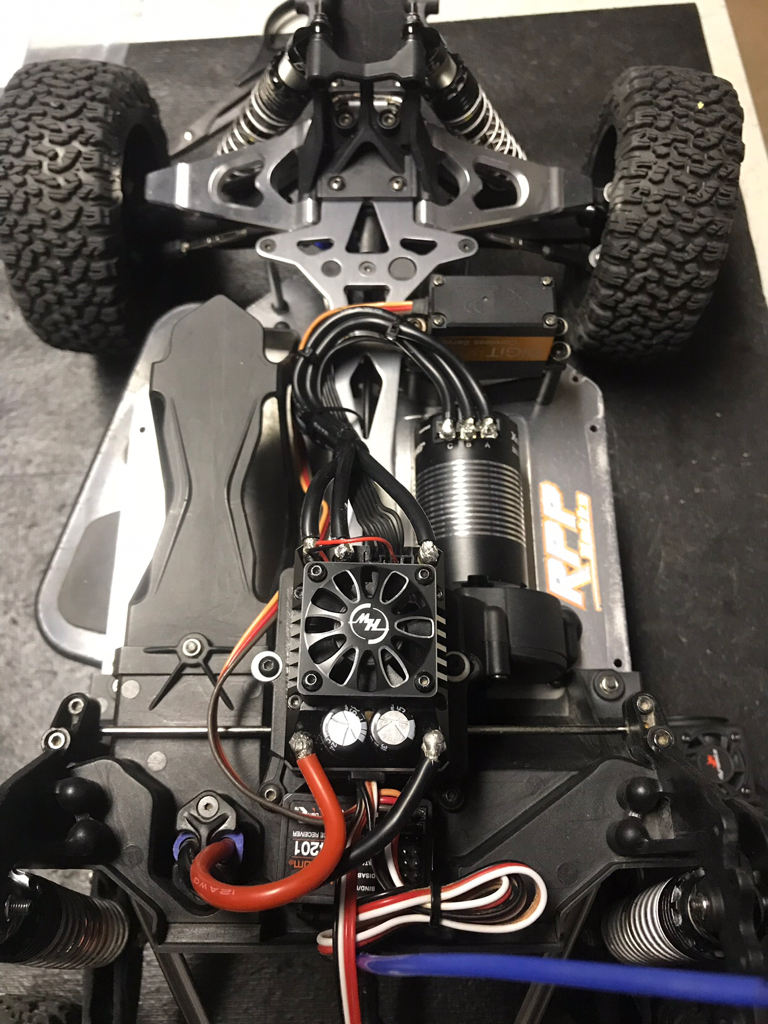

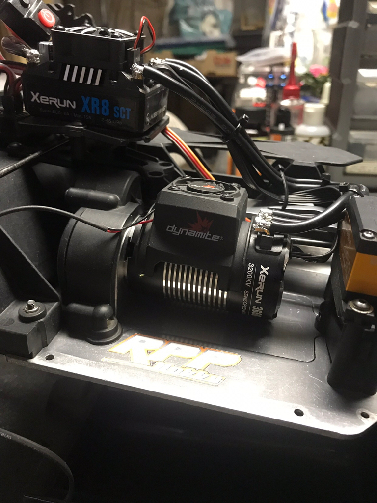

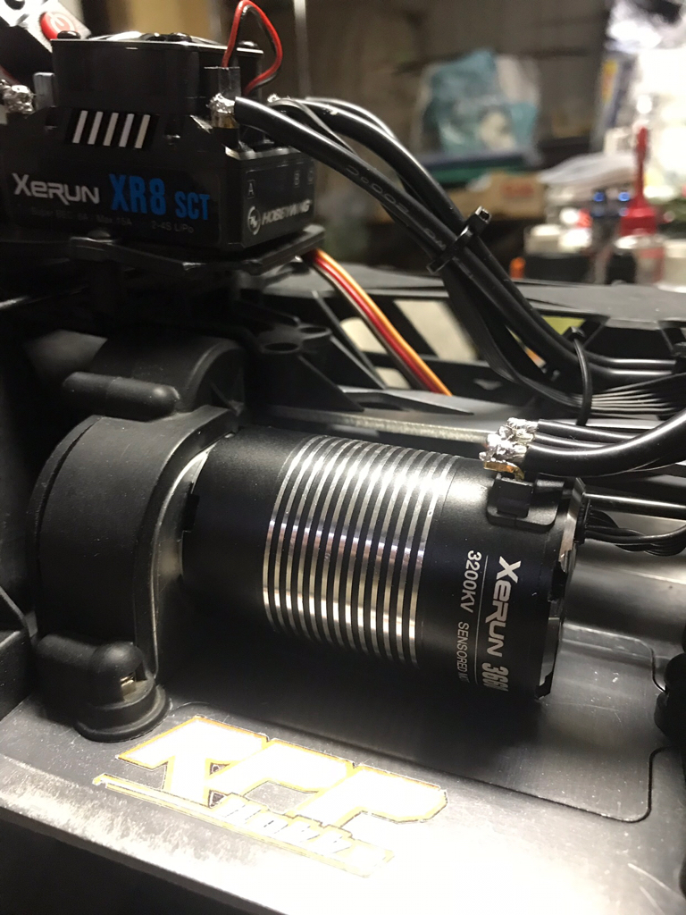

Finally got my rey up and running. Had some issues last summer with overheating so took out the 3600kv motor and put in a 3200. On 3s I’m running an 11t pinion but it almost pulls the front wheels up. I think I’ll adjust the timing and put in a 13 pinion. The 3200 has less topend but a ton of bottom. I need to lesson the initial hit and get a little more speed. It’s a blast to drive this way though. I’m hoping this will make it run cooler.
So I but in a 13t pinion and it’s still way to fast. With the timing adjusted and punch at 3 at about 1/4 throttle it just lights the tires up and twitchy and hard to keep under control. I think I’m going to have to go back to running 2s. Does anyone else have this same motor? If so what is your set up. Don’t get me wrong it’s fun but usually ends up going end over end. In the sand with some paddles it would be a blast though.

Yeah it did. I’m back to running it on 2s with a 13t pinion, might put on a 14 but it’s plenty fast and has awesome torque. I ran 4 2s 5000mah without letting the motor cool and no problems. I haven’t check to see what the engine or esc got to yet. I never had issues with 3s with the stock motor and esc, it wasn’t until I switched and only during the summer but it does get 110 so I’d think anything would overheat.

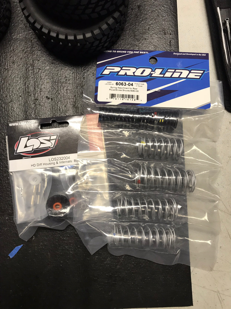

Picked up some stock tires, couldn’t pass up 50% off. Also got some closed cell foams and some proline springs. Going to go a little stiffer on the tender and main spring. I have the first gen model so I’m going to try an open diff in the rear. I was going to try some 30k diff fluid. Does anybody know what they are using stock? If so how do you like it
Are those just the Proline closed cell foams like what's included with most of their sct tires? I've still not ordered new rubber, but I've been considering going back to my stock tires (still good) with my old Proline closed cell foams, but I got cold feet about running with an air gap. I'd like to hear what foam combination you land on.
