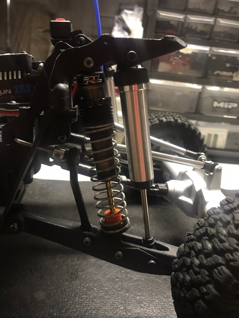

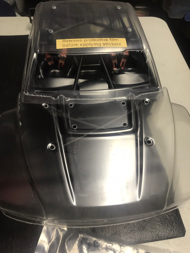

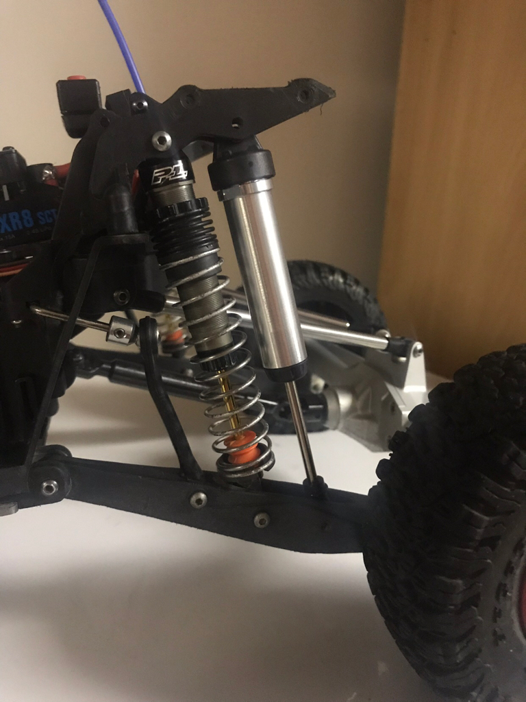

Picked up some front UDR shocks, I think they are 134mm so you lose 5mm of travel but not going to matter. If you don’t want to lose the extra 5mm they make a 139 for the UDR rear that you can use. I also got the raptor body and mount. Haven’t decided on
paint yet so not sure when I’ll have it ready.
