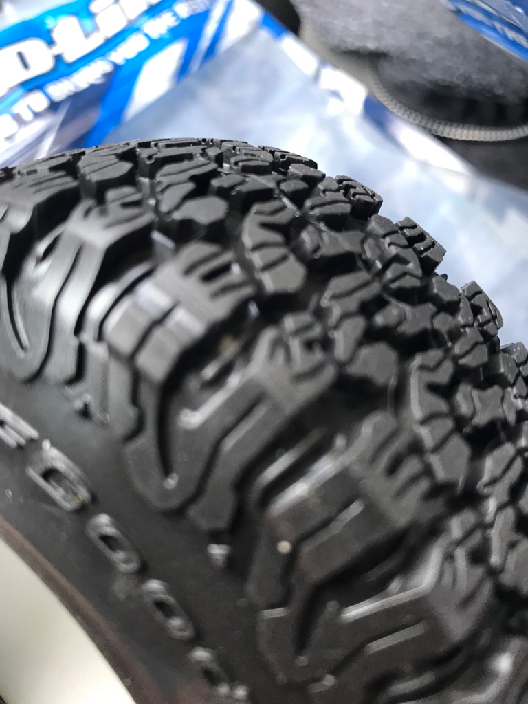

My LHS got some of the new proline ko2 desert tires and they look good, it would definitely look good if you’re going for the scale look. Has anybody tried them yet? I was tempted but didn’t get them but it might be my next tire. I also got to drive the new UDR and it was pretty awesome. I know this isn’t the traxxas forum but WOW. The suspension is perfect for light bashing, it for sure drives just as good as it looks in the video. Needs to be a little stiffer for bigger jumps but that shouldn’t be a problem. Still haven’t driven the SBR but saw it and damn it’s big and heavy. Nothing special, it just looks like a super sized BR. So I put my money down and got the UDR, just sucks I can’t take it home for another few weeks.

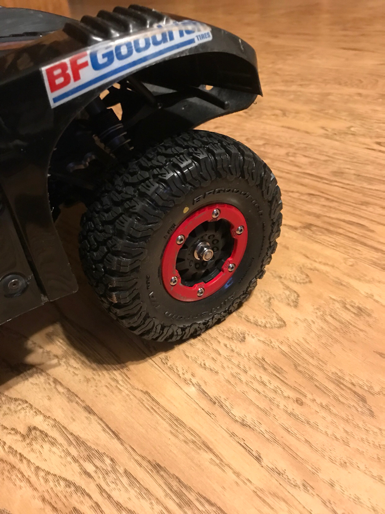

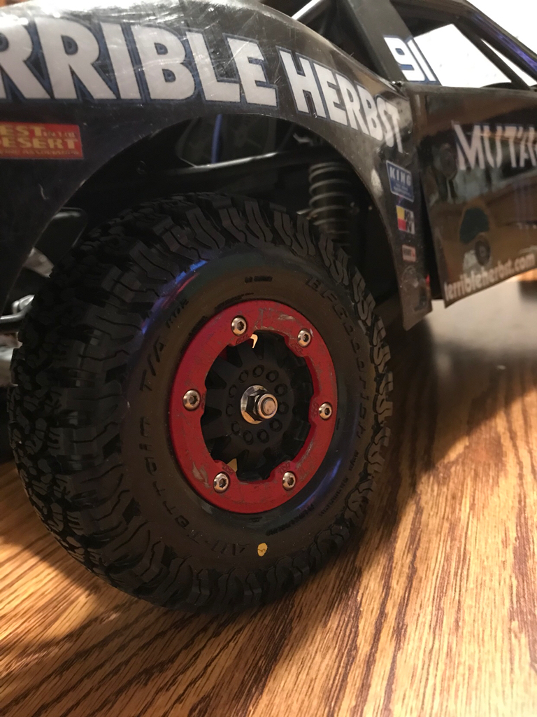

Last time I ran my Baja rey it stripped a hex and lost a wheel nut. Proline tires, axial method sc wheels, slw hubs, slw hardware and 5 sets of m5 nuts later it’s finally fixed other than needing to be glued.
The only reason it’s 5 sets is because I got 1 set of m5 nylock nuts and ended up loosing them, so I picked up 4 figuring they would be harder to loose. Anyways it’s now fixed other than needed the rx case glued back together

Yep. I just got dubro ones as that’s what the lhs had. As for the wheels I went the axial method sc tires and slw hubs to never strip a wheel hex again.... unless something really bad happens

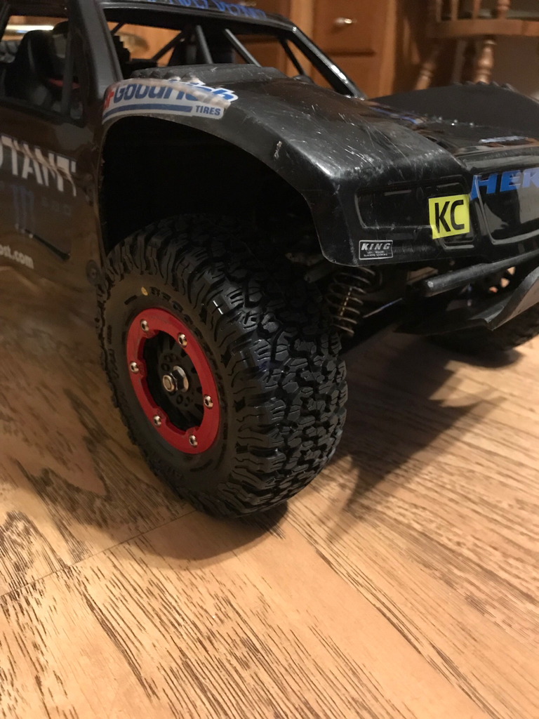

Yeah you should be good to go. I got a set of the new ko2’s. Why they didn’t make a taller version of the kr2, who knows. Personally I didn’t think they were all that great and they wore out too fast.
Looks good baja.
