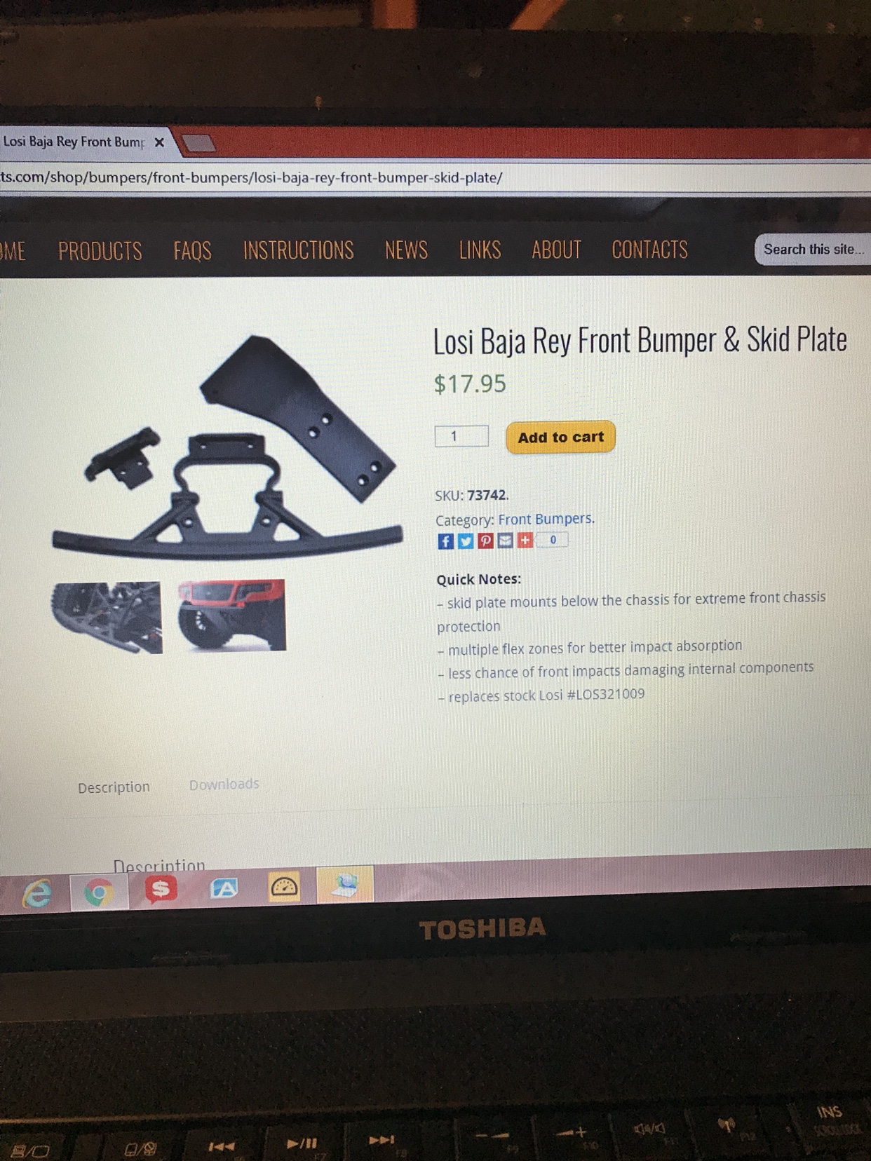

I made a tbone racing bumper for an aarma senton work but it’s a little big and works great but I like the look of this one. I emailed RPM about 5 months ago and they replied there is nothing in the works and they weren’t aware of a problem with the stock bumper. After a few more emails they asked for pictures of the bumper failure and said they would pass it on to their engineering department. It’s nice to know they listen to their customers. I’d recommend if anybody has something they would like to see them make send them an email and if it makes sense it sounds like they will make it

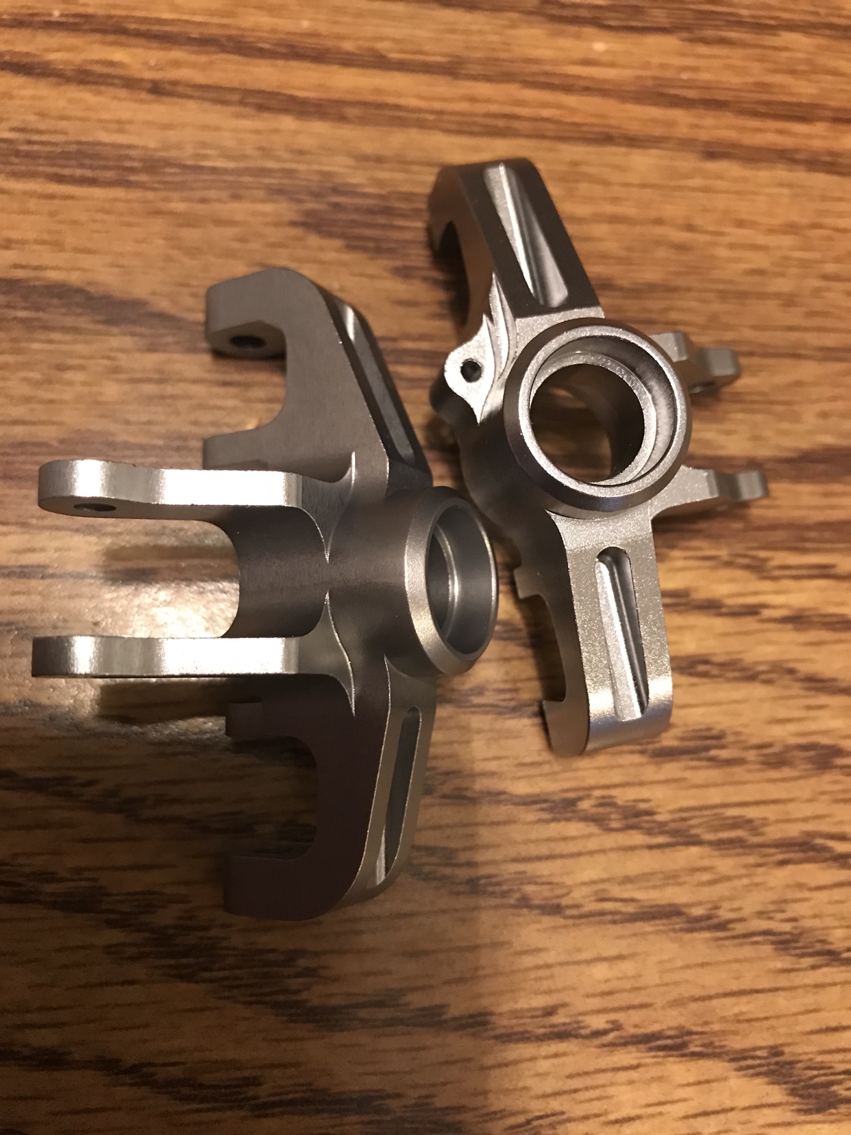

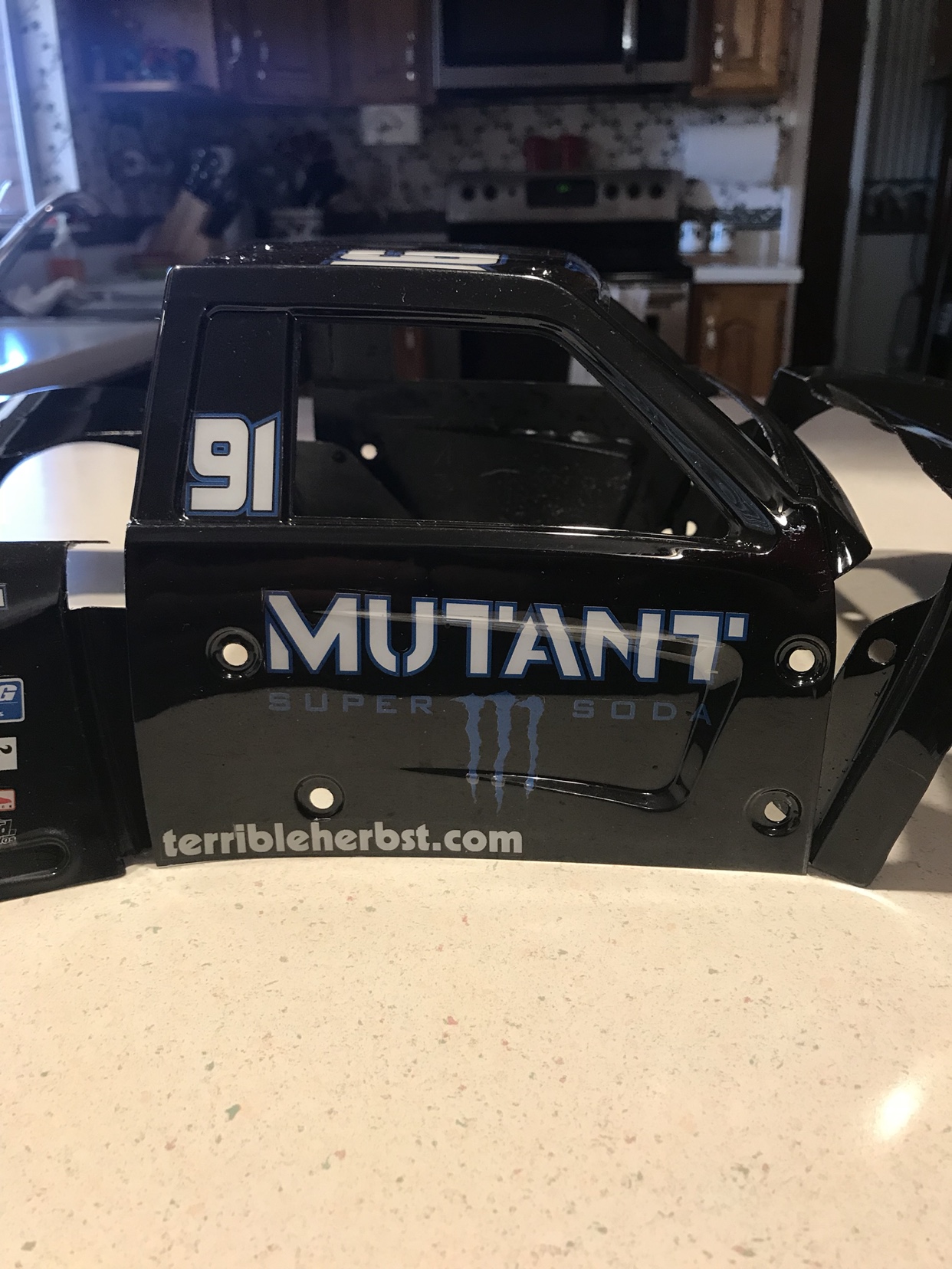

Finally got some aluminum front spindles and body from SIKRIDES in vegas. The body was slightly used but still in great shape. Those guys and girl are awesome! Recommend stopping by their shop or check them out online

The new bumper definitely improves "rough transitions" where the front skid hits something like the edge of a sidewalk at-speed, and the truck has to slide up and over the edge to keep moving forward. Haven't had any end-over-end accidents since I learned how to drive the truck properly.

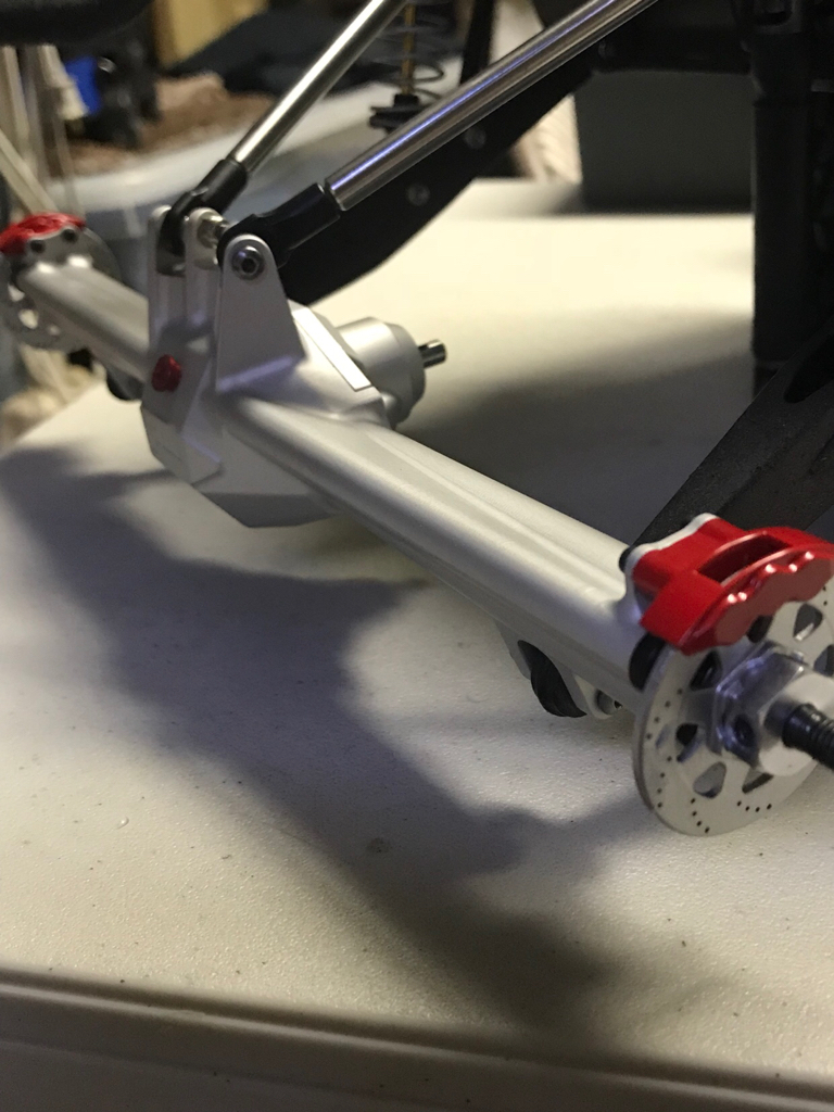

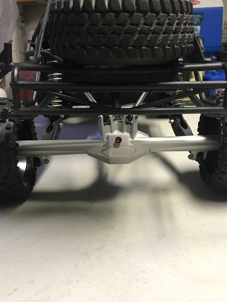

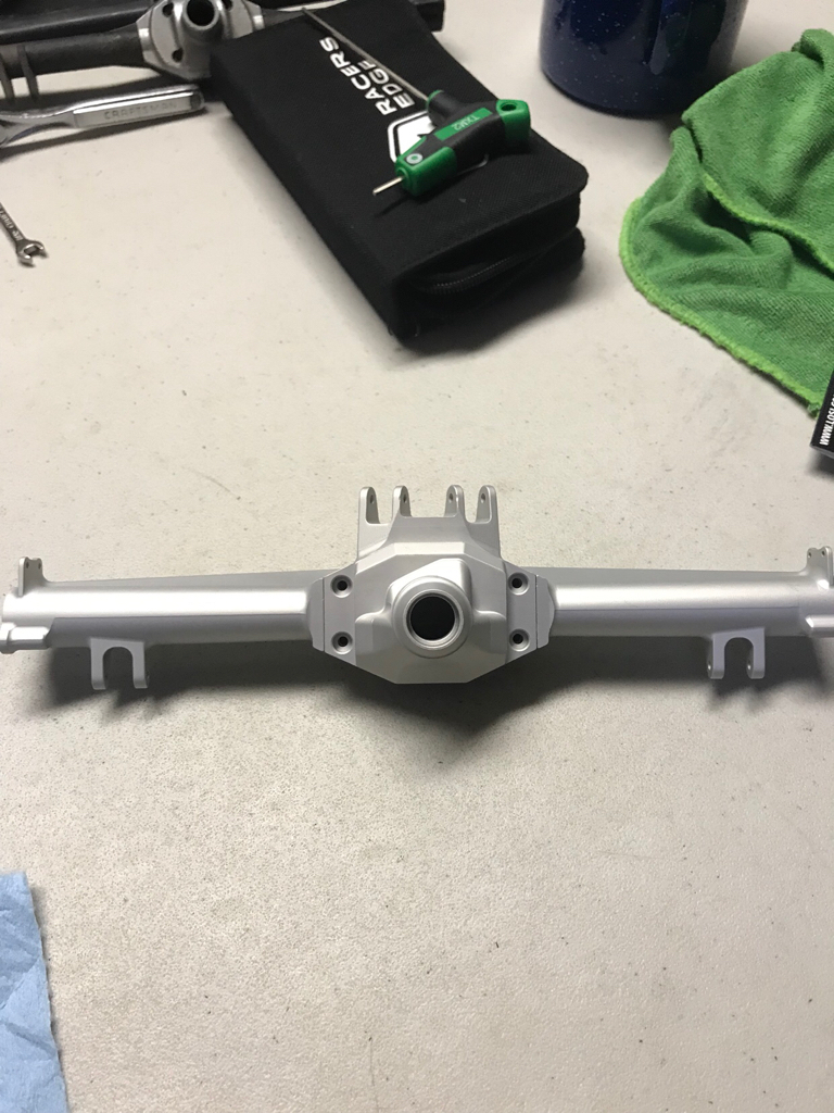

Have been debating on buying an aluminum axle but couldn’t resist. I wanted the black one but figured this one wouldn’t show roost and rock damage as bad. The fit and finish and detail are amazing. The gear mesh is spot on and it just looks bad ass. Can’t wait to run it.

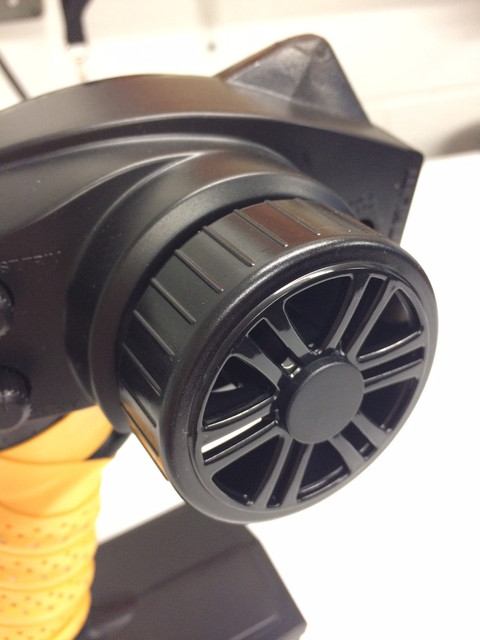

The cheap transmitter look and feel was really bugging me, especially the hard plastic steering wheel. If my hands got sweaty in the summer, my fingers would actually start slipping on the wheel. I tried adding foam from another transmitter but this wheel is so big it split the foam in half. Wasn't sure if any aftermarket wheels fit so I was ready to give up and buy a different transmitter until I had a really simple idea. Plasti-dip! Just take the wheel off and spray on a few coats. It gives it a grippy rubber texture that makes a difference. I assume any color Plasti-dip would work, I happened to have clear on hand.
