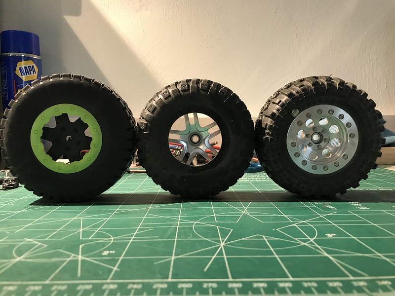

FYI the tires on the original Baja Rey are not standard short course tires either. They are a good bit taller and the only other trucks that have tires close to the same size are the Yeti TT and the Losi SCBE 1/10. So, it’s not uncharted ground for them to offer a wonkie size tire.
Edit: Left to right, SCBE/BR stock tire and wheel, Stock Slash 4x4 tire and wheel, RC4wd M/T short course wheels and proline SC TSL's.
