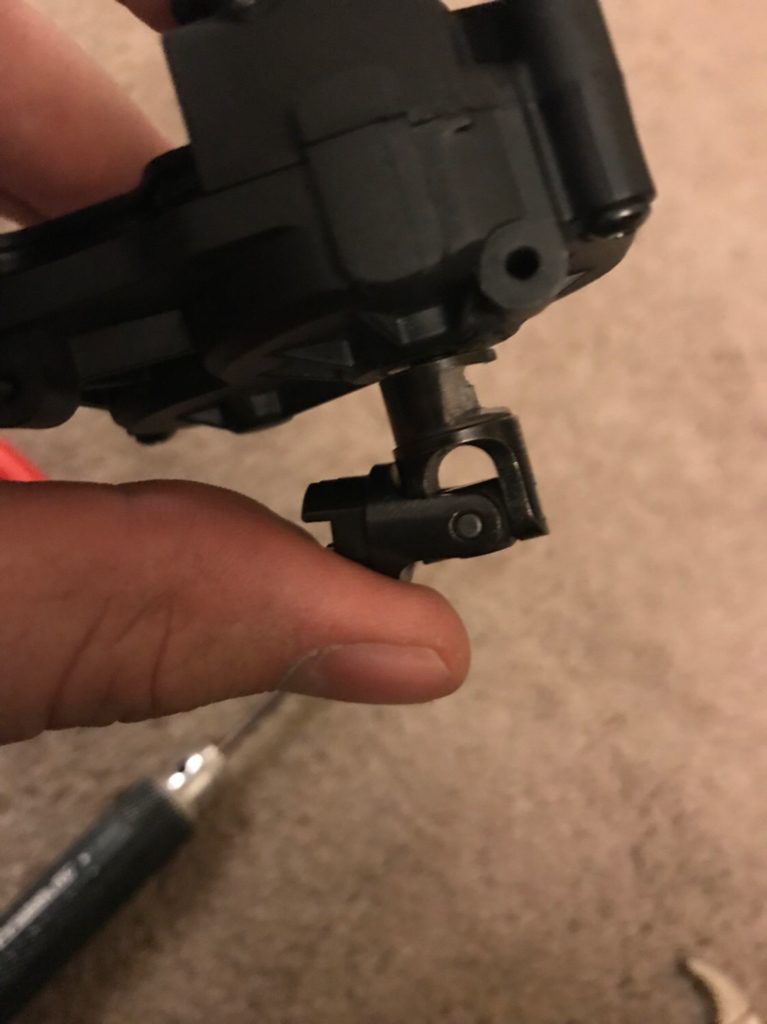

Have any of you guys ever stripped the set screw for the rear driveshaft on the transmission side?
I’ve ground it down with a dremmel far enough that there is no way that the threaded part of the set screw is even there, and the rest of it still won’t come out!
Update: it finally came out.... but now the outdrive has to be replaced and the driveshaft as well...... I love rtr’s
Hasn't happened to me. But as a suggestion, use blue Loctite on that screw, not red Loctite. I often use red Loctite on screws in similar positions to make damn sure they never come loose by accident, but as you've discovered that screw is just a little too soft to handle the torque necessary to break-loose red Loctite.
In fact, if you use blue Loctite, loosen the screw a bit when the Loctite is half-cured, then re-tighten it, so the Loctite will be a little weaker.
Yea I always use blue loctite on screws. Unfortunately I never actually put any on that screw as I wasn’t able to remove the driveshaft until the outdrive itself was cut through. So I have to replace the diff outdrive and rear driveshaft on a rc that has never been touched by a hex driver.
