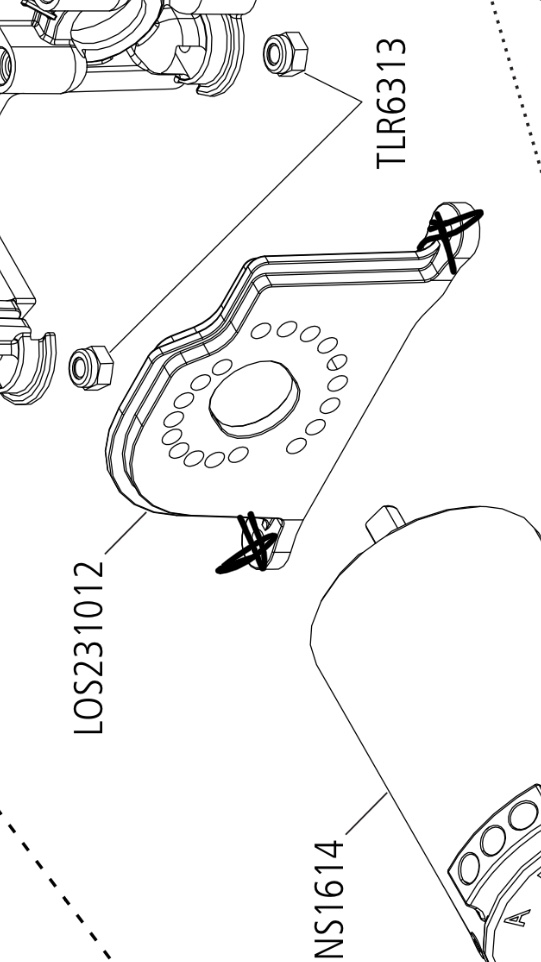

I'm gonna have to try that thanks! I'm just not sure where you're talking about putting the washer
If you remove the cover plate then the motor mount , You have the slots either side where the motor mount slides into as it slides into its final position either side bumps upto a plastic flat , sit the washers onto the plastic housing then slide the motor mount down , the washers sit where the x’s are shown in the diagram

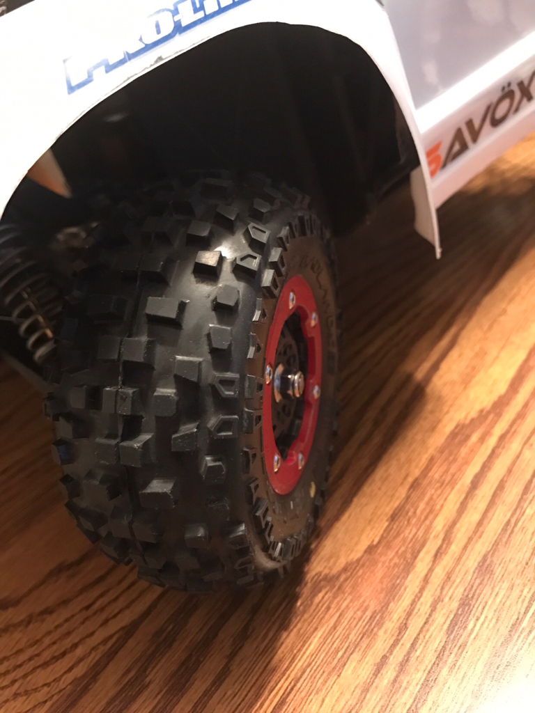

Ran a set of badlands on the rear just to see how they would do and they did really good so got some for the front. They hook up really good and can still slide it around. Not as scale as the desert claws but still look really good. Not sure if I like them as much as the gladiators, haven't ran them as a whole set yet but going to run a few packs on my day off this week.

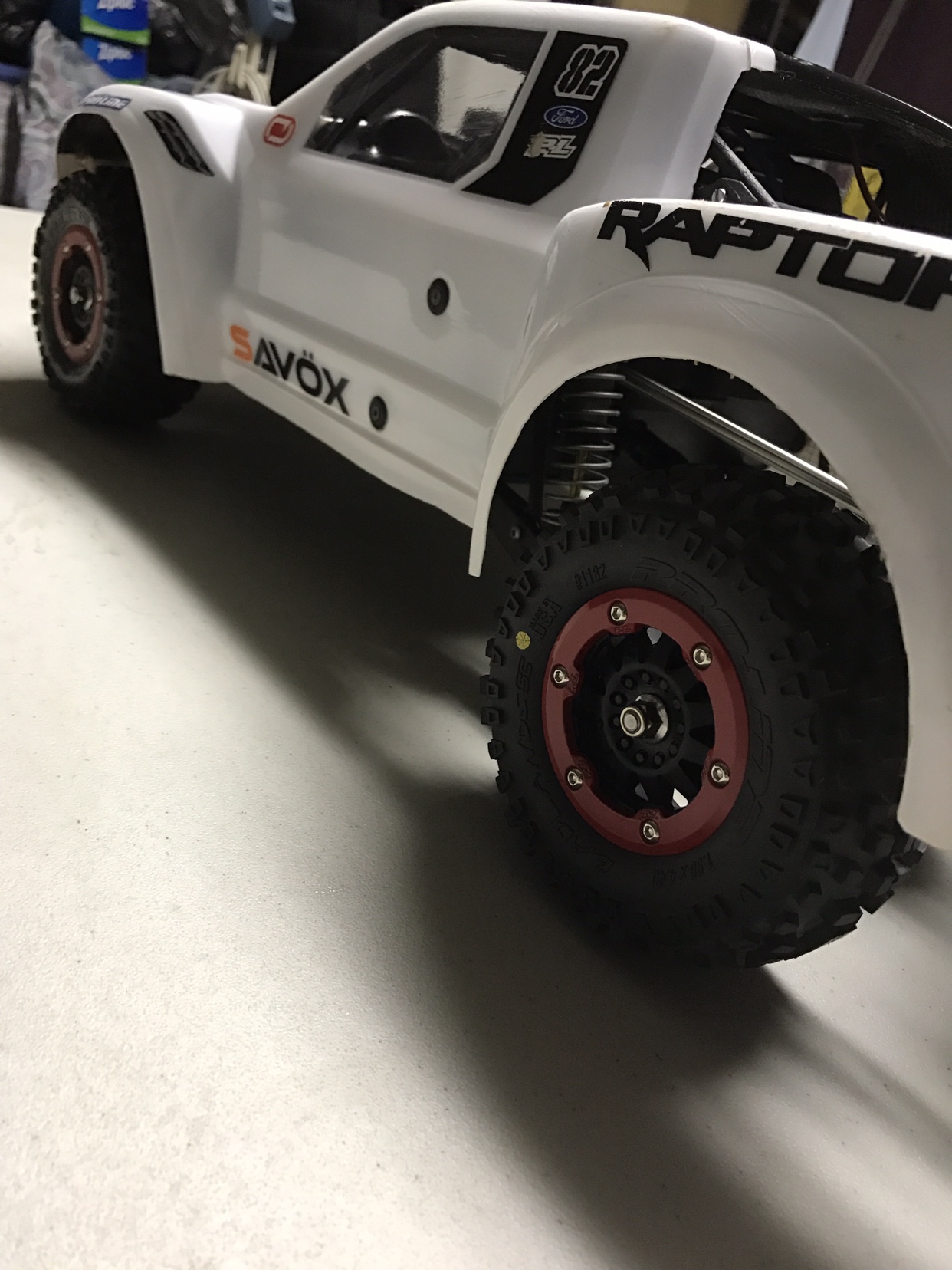

Some more muddy, slippery shenanigans with the Baja Rey today! Truck is a total pain in the a55 to clean afterwards, but damn is it fun. I've set up some 10-15 foot drifts coming in hot to this back turn and just laughed out loud! "backin it in" as they say! Running the oem buddy for basher days like this, gotta keep the shelf queen clean and pristine!

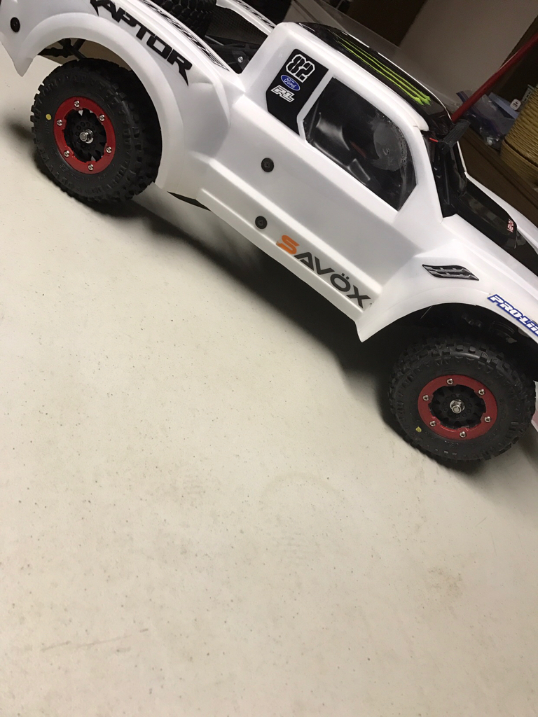

The Raptor body turned out pretty sick!"thumbsup" I think i'm gonna have to go that route now that the Baja Rey bodies have increased in cost so much!

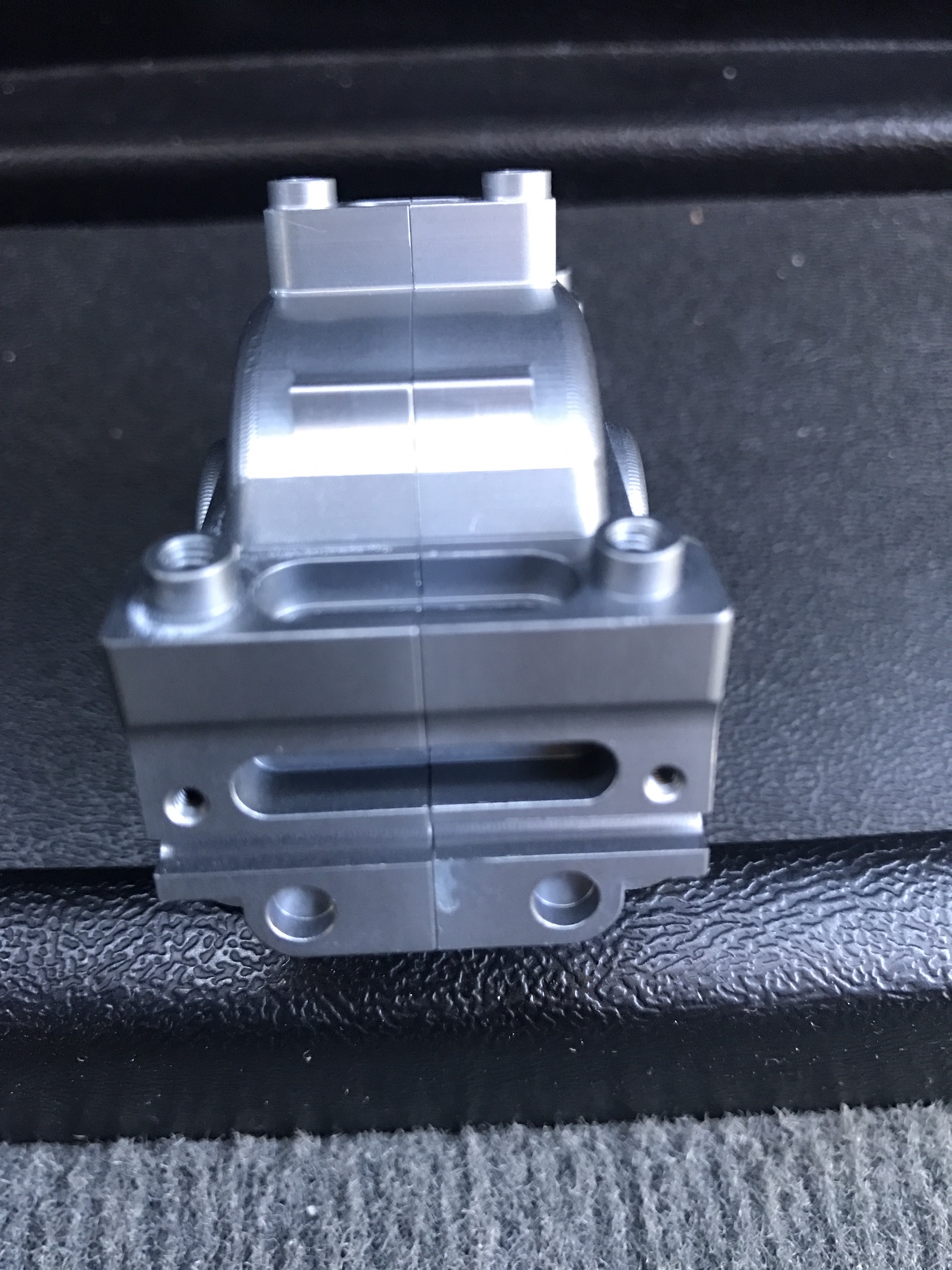

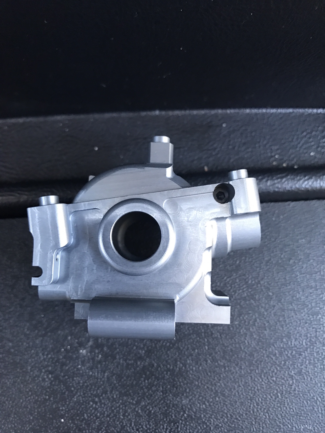

Wow. I would've stopped driving on 3S long ago if my truck was totaling its front diffs on a regular basis. But whatever, at least the front housing solves that problem. I'm looking forward to mine arriving, so I can finally have zero worry about repeatedly mashing the throttle on my Baja Rey.
A suggestion for fitting the front housing: Sand the mating surfaces of the two halves using ~400-grit emery paper, to make sure they're flat. That will minimize grease leakage and dirt intrusion. These aluminum parts are never milled perfectly, and they can't squish together to form a tight seal like plastic parts can.
EDIT: Actually, this part doesn't need the edges sanded. The inner edge of the diff housing has a lip on one side that fits into the other side, to form a tight seal. Sanding the edges *does* help with cheaper parts, though.
Actually, I fitted it together and snugged it down prior to assembling to check that very thing. It looked about perfect. As an added precaution though, I used a small amount of silicone gasket sealer and smeared it around the mating surfaces. It's like a frog's ass now, water tight!
Yeah, mine just arrived and I see there's a lip on the inner edge of the diff housing on this part, so it doesn't actually need any sanding to achieve a tight seal. The two halves fit snugly enough that they stay together even without the screws installed, yet they aren't hard to separate either. That's a nice touch, and probably adds several dollars to the production cost of the part. Well done, SSD!
