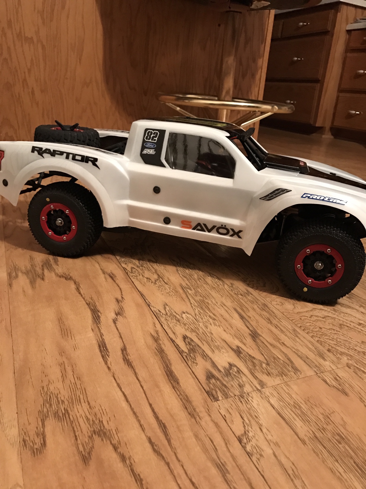

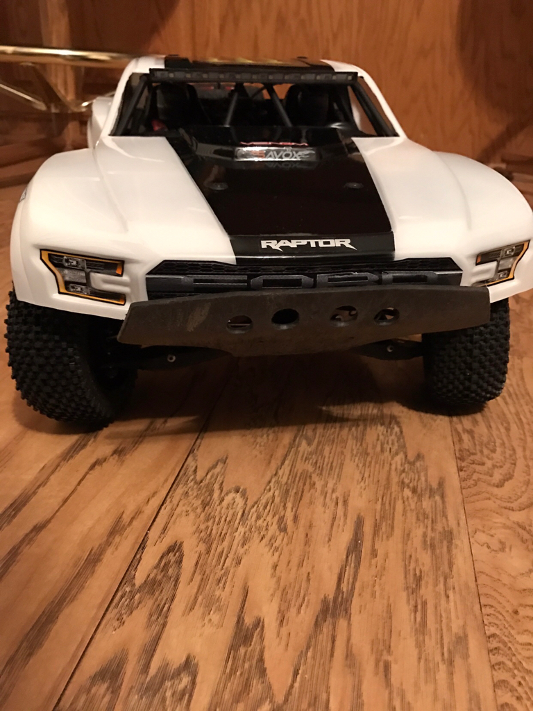

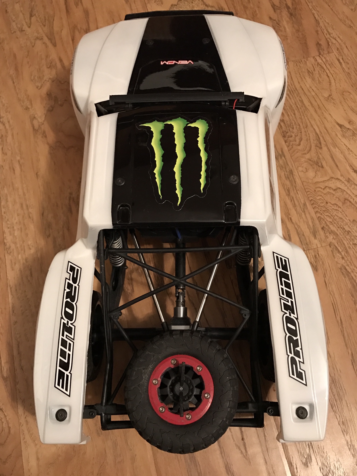

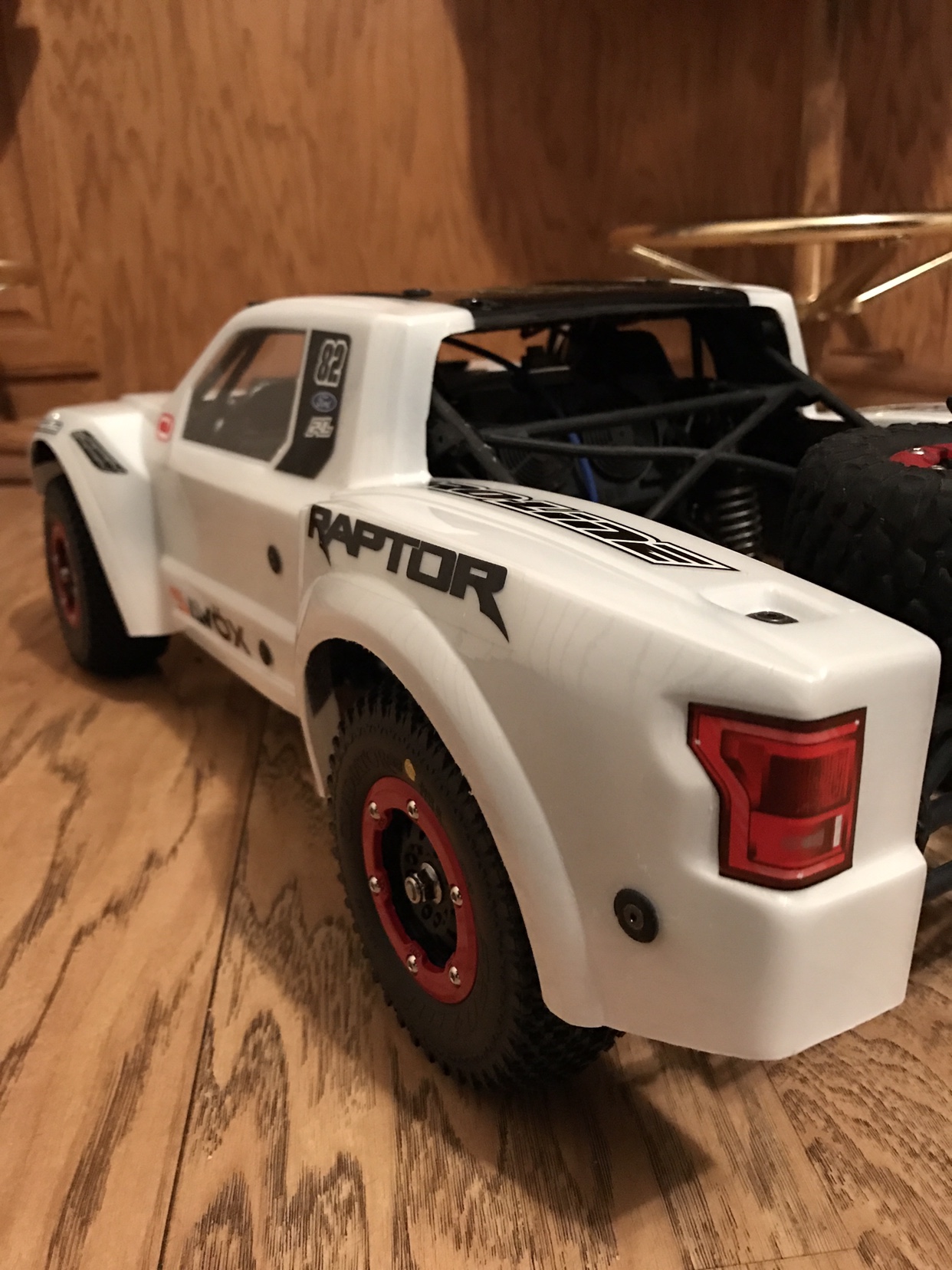

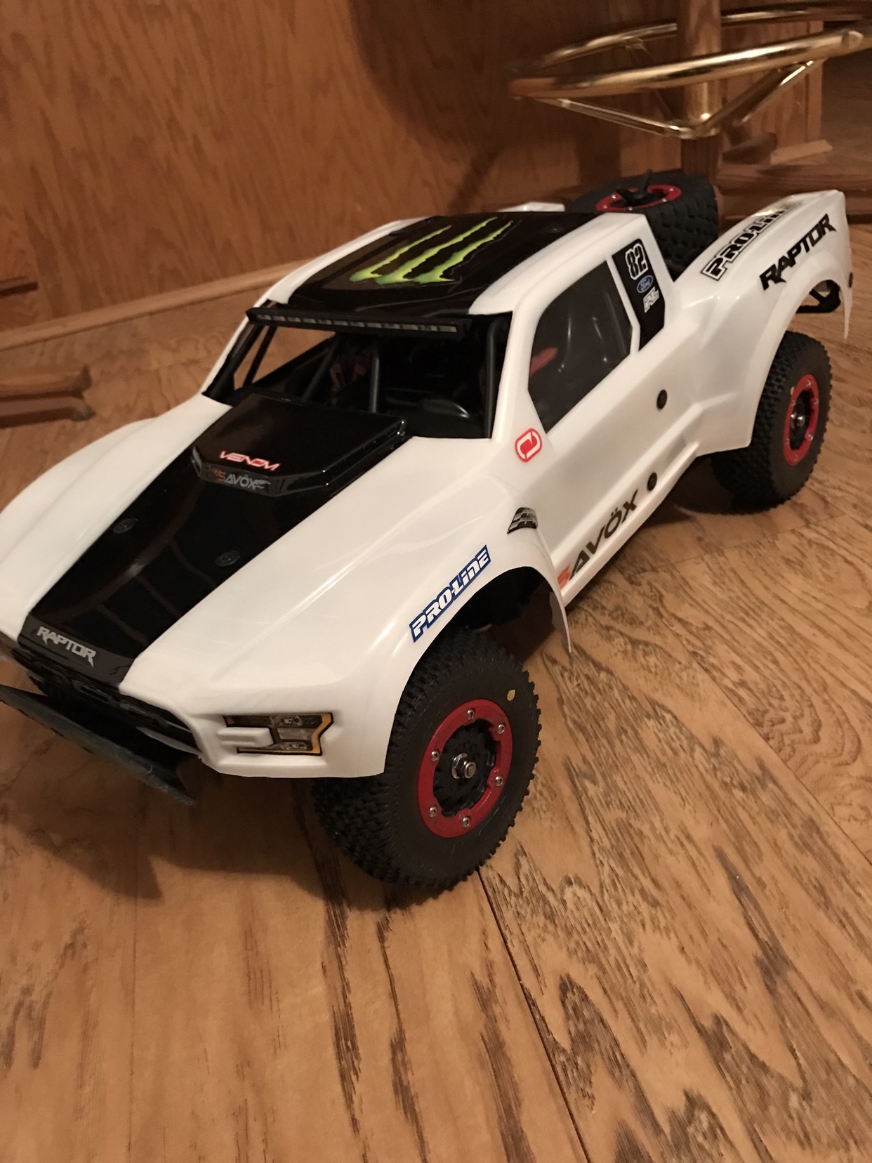

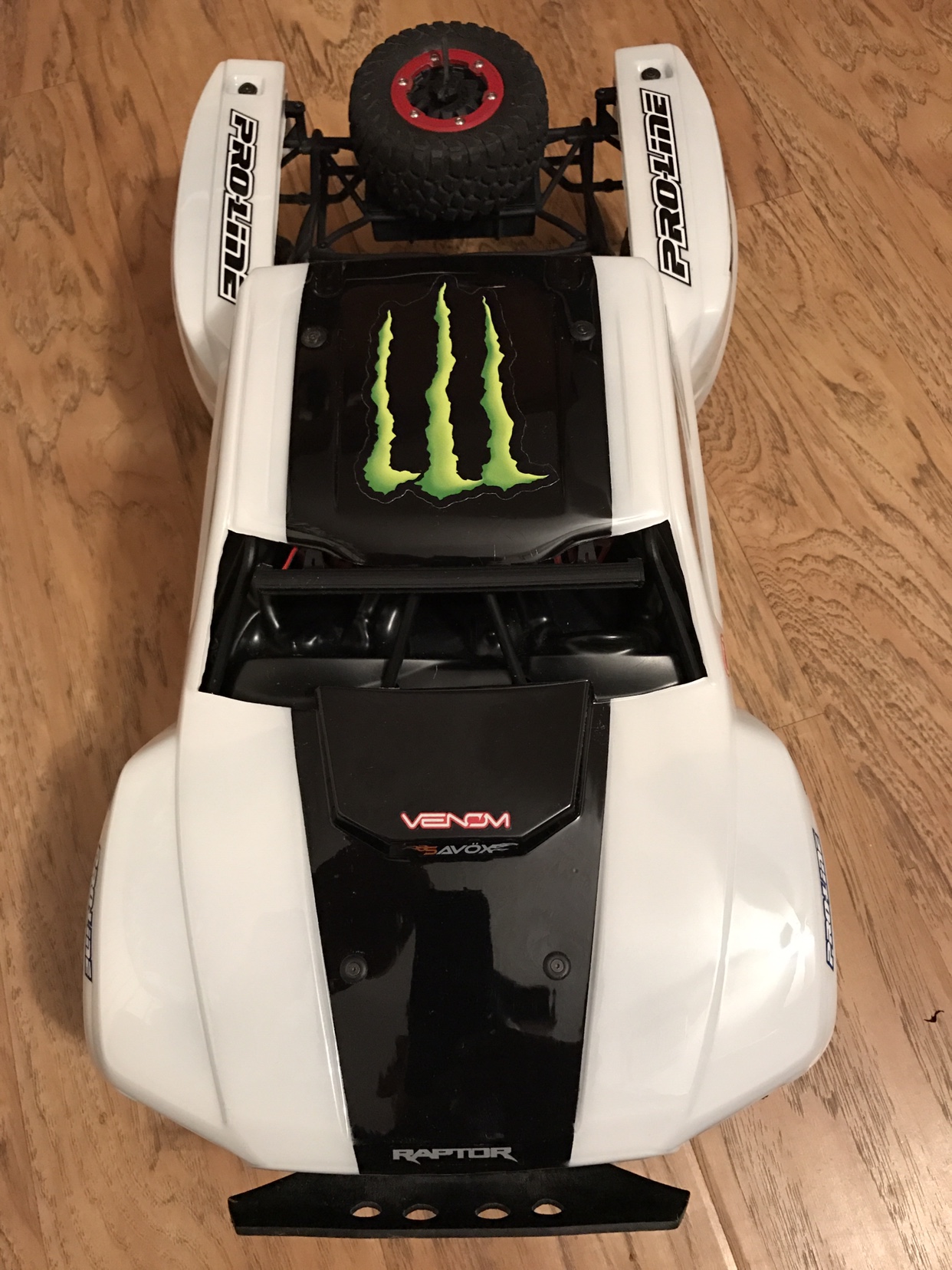

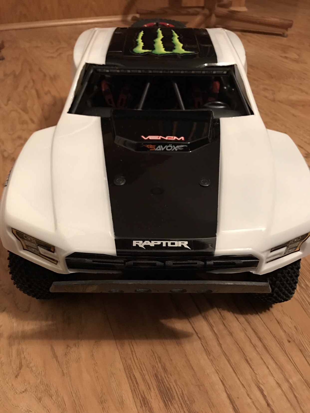

So i finally got my pro line yeti raptor body on and it turned out pretty good. It lines up almost perfect and i was able to use stock mounting screws and plastic washers just not all of the stock locations but i didn't think it was necessary and finally came up with a way to secure the rear fenders. The rear top mounts didn't line up. I'm also going to try out a set of pro line gladiators. They are a little bigger then the kr2's and just a couple mm's shorter then the stock desert claws. So after i become a paying member whats the best way to post pictures? Is tapatalk the way to go or is there an easier way...thanks

Oooooo! That does look good! For 1/2 the price of the Losi, you may have found my next body.

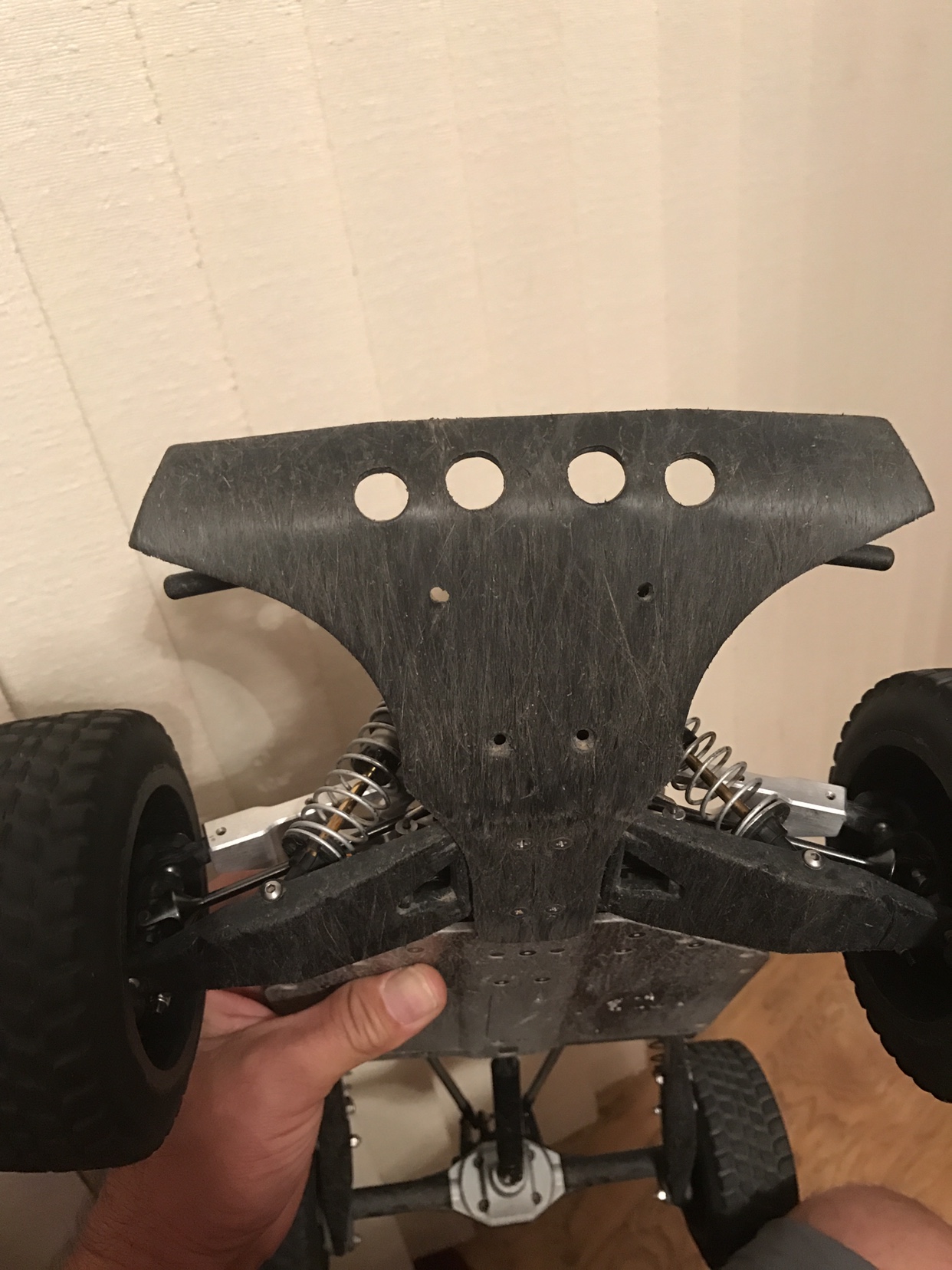

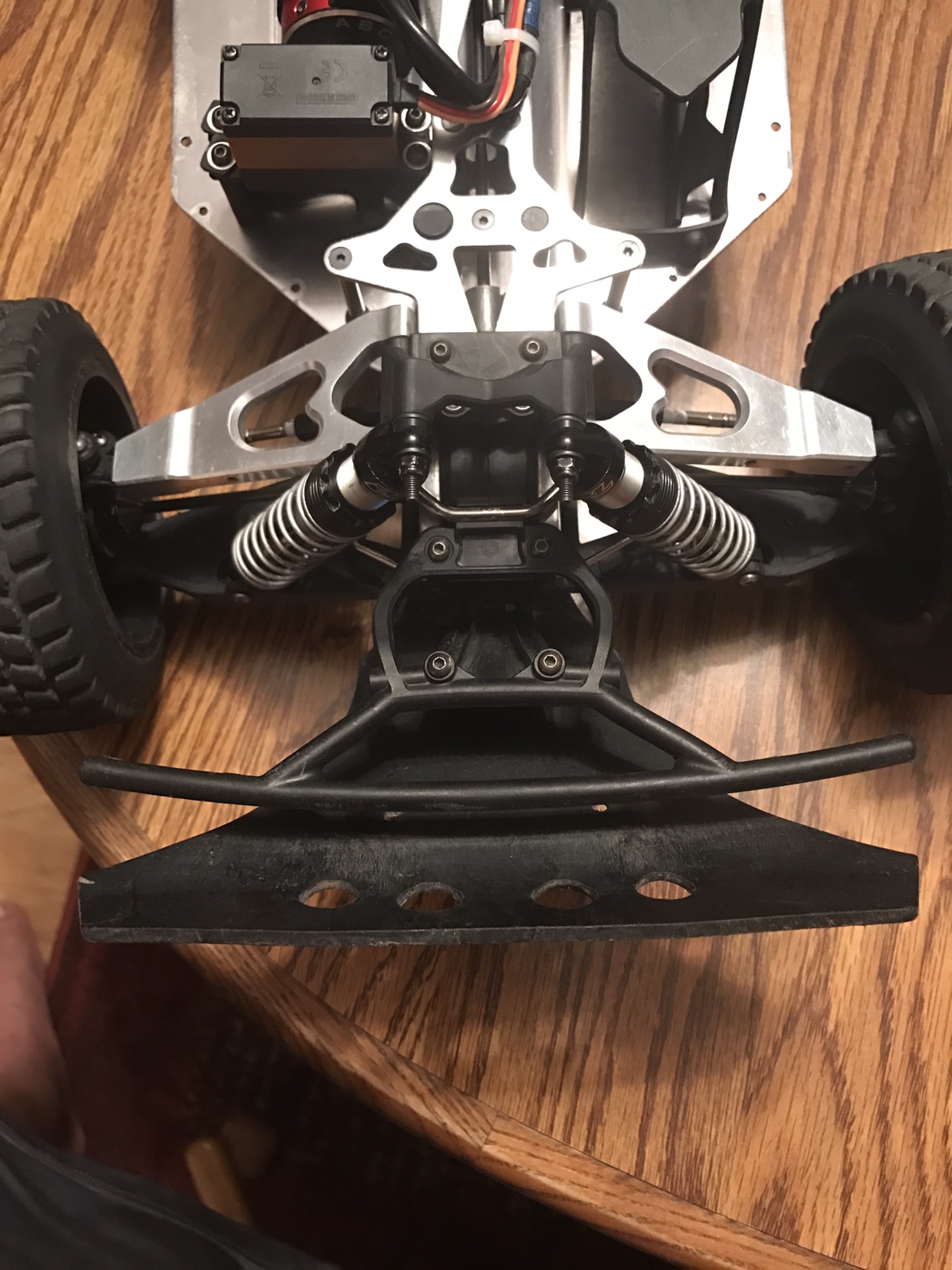

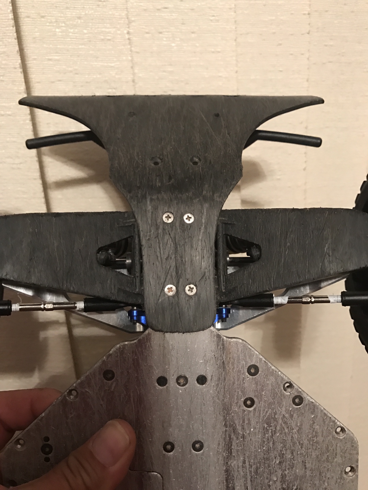

Is that a T-bone Rock Rey bumper on the front? Do you have a picture head on and/or from underneath?
Yeah I think it's the one for the aarma senton. It came with longer screws and I just screwed it in to the bulkhead, it was pretty easy. Just had to trim it a little so the lower a arms had full movement and

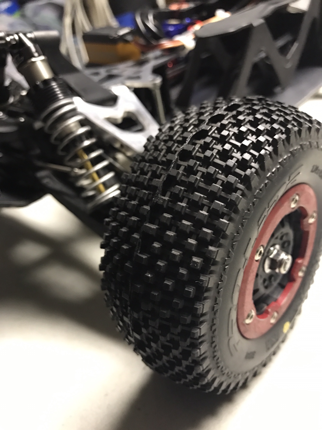

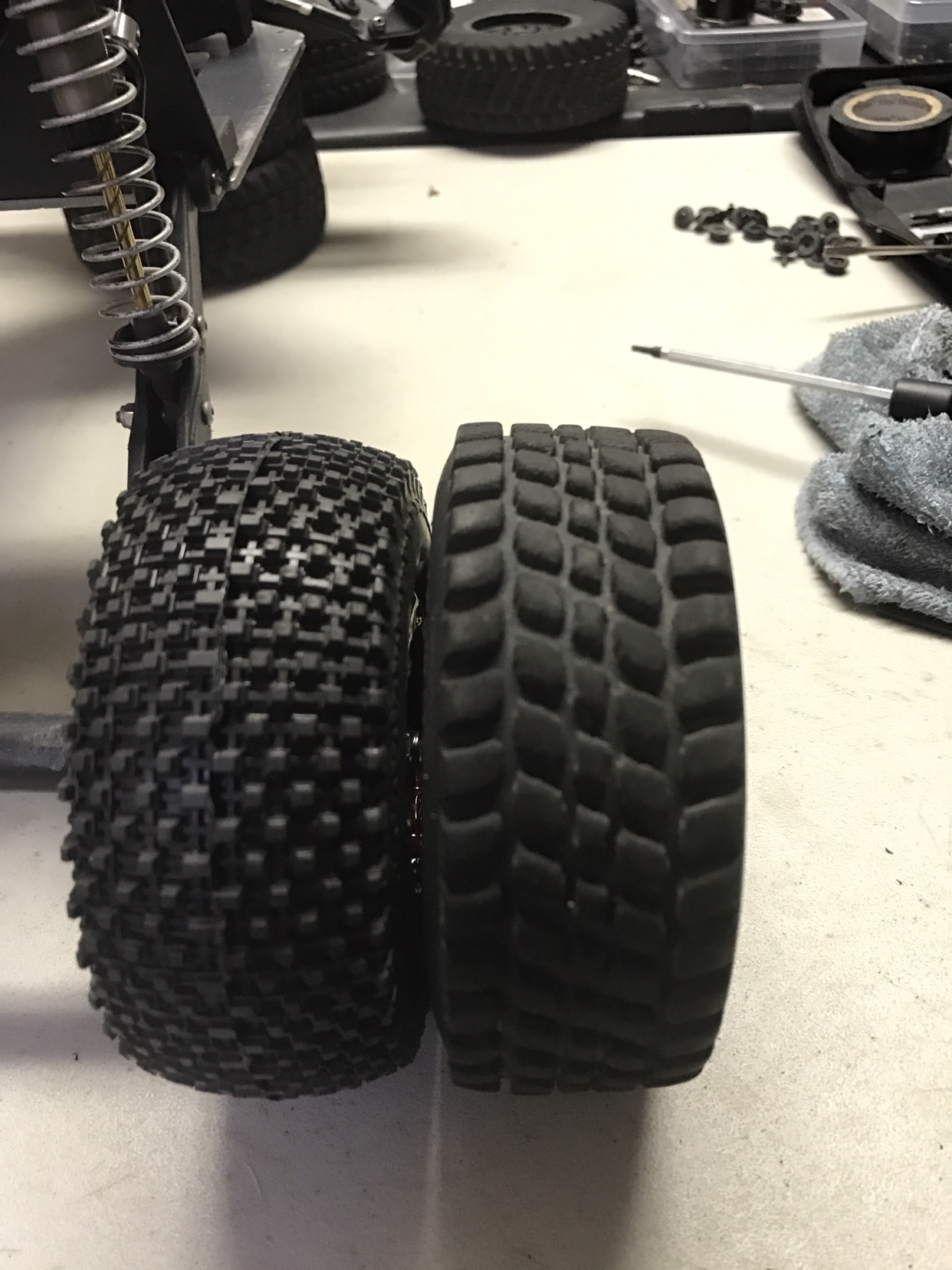

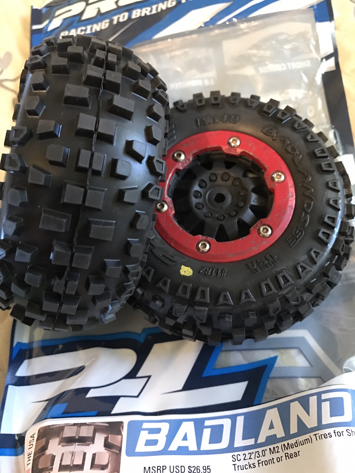

So I ran a few packs with my new pro line gladiators and they are awesome!! You can still slide it around without traction rolling and they seem to work good everywhere. When the track drys out it's slick, it's hard pack with a layer of dust on it but these tires still hooked up so good on it. I would rate them over the kr2's and the stockers. After 5 packs there is no sign of wear on them. They don't have the scale look of the kr2's but they still look good on the truck since they are about the same size as the desert claws.

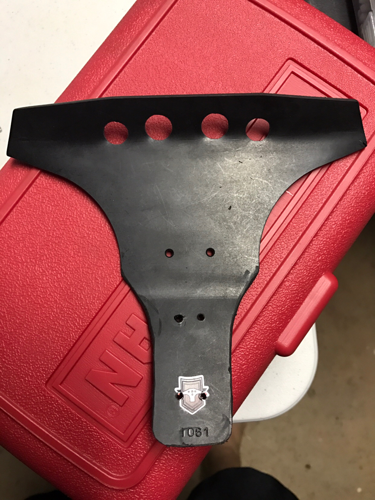

I do like the function of those T-bone bumpers, but if I'm going to need to modify the crap out of it, I'm starting to think I should give a shot at making my own. Are they just made out of black UHMW-PE? I see a dollar store cutting board and a heat gun in this truck's future.

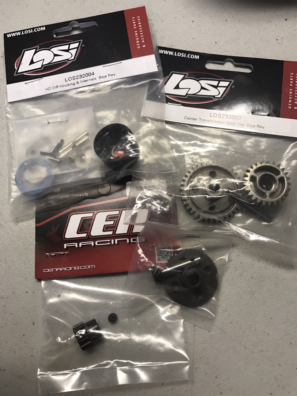

Does anybody else have a really noisy Baja Rey? I use to lightly grease the trans gears but attracted to much dirt so I don't anymore but damn this thing is so loud and I just had it torn apart and re greased and replaced bearings but still noisy. Going to replace the ring and pinions as well as trans gears and putting a 12 tooth motor pinion gear. RPP hobby has 15% off pretty much everything so ordered a ssd bulkhead too. Hopefully that will turn things back to normal.

Have you tried the 1mm washer between the motor mount and transmission housing , A trick I saw Micheal Pham (I think he works for vanquish) talking about it on the Facebook rock rey page and gave it a go and I shit you not it works 100% ,
Definitely quieter ,...try it I think you’ll be surprised obviously creates a tiny step on the underside of chassis plate but nothing really !
I'm gonna have to try that thanks! I'm just not sure where you're talking about putting the washer
