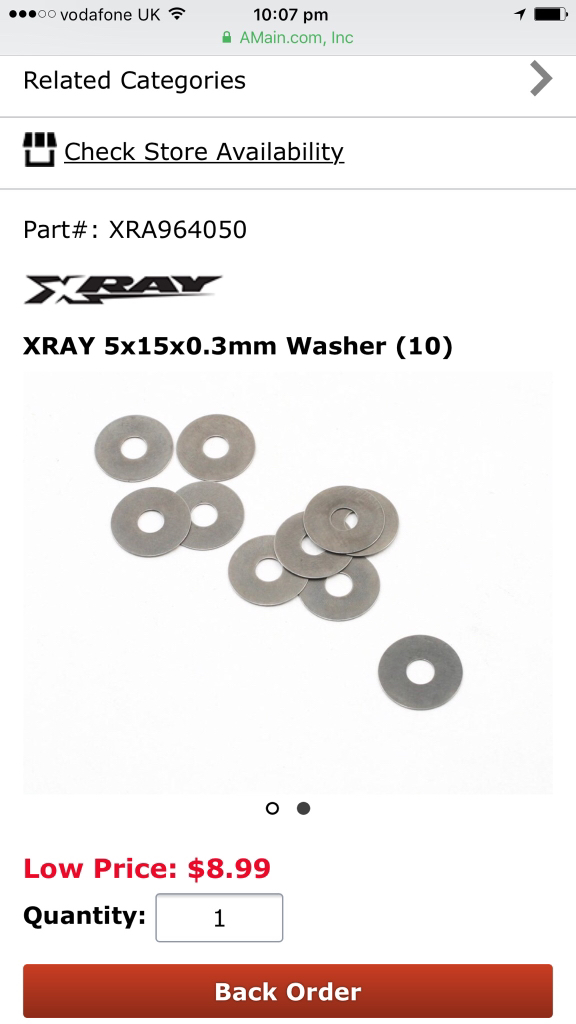

Ok, so I definitely have the concaved washer going on in the front diff. Center diff everything looks great. I'll replace the front diff parts and see what that gets me. Thanks to everyone for all the feedback!"thumbsup"
Don't forget to upgrade the washers with these
[emoji106]
Awesome - I'll order some up. I ordered all new parts for front and center diff. I'll get those washers on the way as well."thumbsup" I did have some laying around in my parts bin, and was able to use one of those to get everything back together. I then filled center diff with 30k diff fluid. She's "alive" again!
